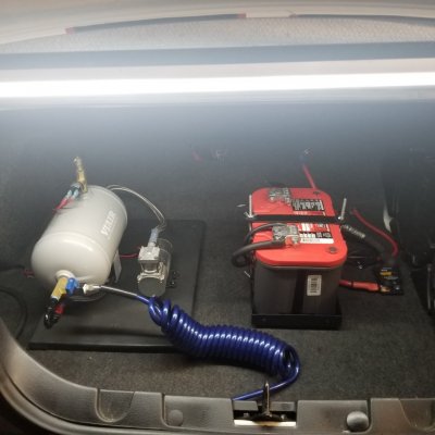

Here is a pic of the power distribution and compressed air for boost controller finished up last night

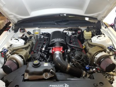

Also replaced my intake pipe to handle the boost levels so we don't have the pipe blow off

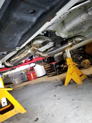

Beautiful! Im running MBRP as well. Love them. Videos when dyno and on the street!

finally got her running last night did some data logging, got the stalling issue after reving her up fixed, ac blows ice cold, rpm, temp, oil pressure, battery, and speedometer gauges all working, going to do some heat cycles to seat in the rings and wear her in, all in all it turned out great could not be happier,
