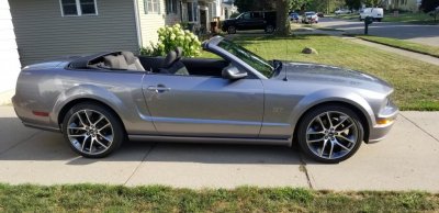

I have an 07 Convertible GT. I installed Ford 20" rims and tires off a 2015 GT (see pic). I used my same lugs from the 07 and it all worked fine. I can still drop her if I decide. You should have no issues.20190805_180756.jpg
