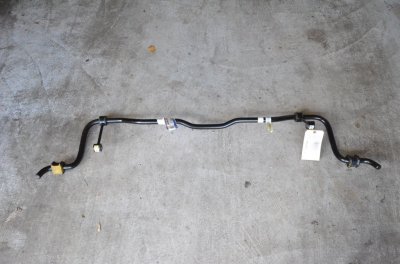

So I am thinking of upgrading the rear sway bar on my 2014 Bass Mustang with a Boss rear sway bar. Just wondered how this was done so I go to youtube. Only thing available on youtube was for installing a rear sway bar relocation kit to so that 15 inch wheels and drag slicks can be installed.

@LarryJM are you saying you want to install a boss rear sway bar on your 14 gt?
Yes I already have it. It's just several mods I want to make. The Big Brake kit is already done and works great after the second bleed. I intend to install a Track Apps Cluster later. The Boss Bar is waiting until the weather gets better.

@LarryJM I installed a boss rear sway bar and upgraded the bushings to poly. I didnt have any hang ups really on my 2005 gt. pretty sraight forward.
The issue seems to be using 15 inch wheels with this sway bar. They sell a rear sway bar relocation kit in order to use 15 inch wheels. So if your 2005 Mustang is using wheels bigger then 15 inchs, your good to go or so it seems.

10” wide 15” wheels with a 7 1/4” backspace will contact the sway bar mount on the rear end of an 05 to 14 GT. It does not matter what sway bar is used because it is the mounting bracket that interferes with the wheel. Cutting about an inch off the mount and using a relocation bracket allows the wide 15” wheels to be used with a stock style sway bar. Larger diameter wheels clear the mount without modification.
