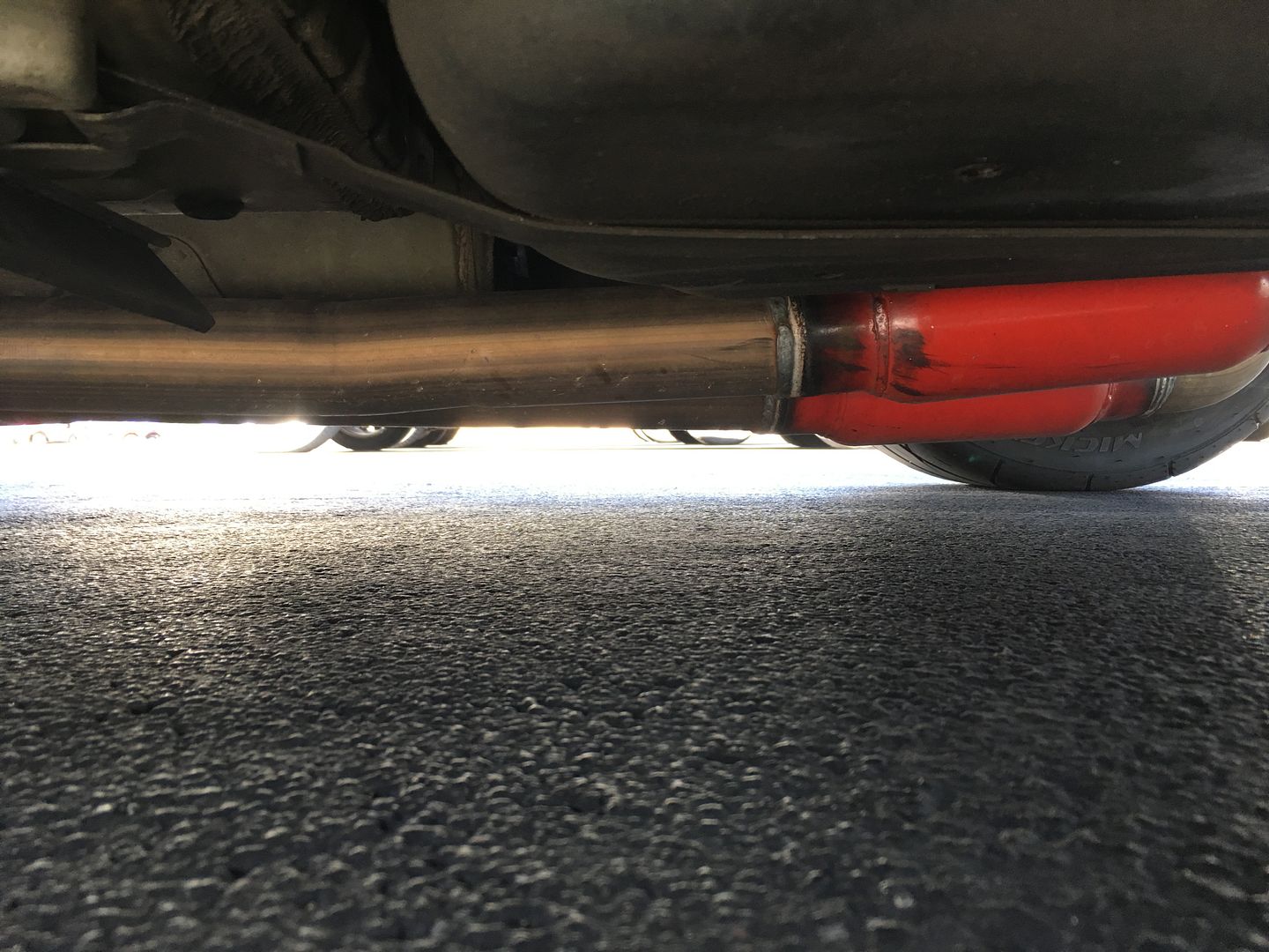

Theres boss, man thats old school but cool. Hows it sound now?
I can understand (and forgot) if youre lowered you will have clearance issues, which Im not, but having the mufflers fit is not an issue. Ive seen people run borla stingers mid mounted and theyre not as thin as slp or m80 straight throughs.
Old school for an old fart. You should see what I'm building now.
Sounds loud as fuck but now is more refined with less trumpeting. Even with my stupid low CJ RA springs I don't think I have any marks on those. But all of my clearance issues are up front. When I used to swap in my catted mid-pipe I used to bang the cats but they were right behind the front wheels. With my raked stance there is plenty of room farther back.

I have a set for sale, just like the ones that 07 boss is running. New in the box, if any interest. Pm me.
They're Flow tech red hots. 2.5" in and out.
