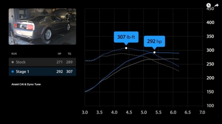

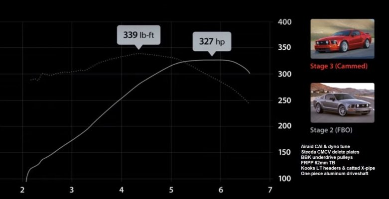

There's two routes to achieving 400rwhp from a 3V engine:
1. Naturally-aspirated.
You'd need to just about throw the kitchen sink at a stock short block (CAI, 62mm TB, intake manifold, ported heads with upgraded valve springs, SPR cams with phaser limiters/lockouts, LT headers/mid-pipe, EWP, underdrive pulleys, plus a tune to get that amount of power, and it just isn't cost effective. Even then, you'd still need an aluminium flywheel and driveshaft to reduce the drivetrain loss in order to get to 400rwhp SAE from a NA 4.6 3V. AFAIK, nobody has pulled this off.
Some e.g. BBR claimed in the past to have gotten over 400rwhp from a stock NA 4.6 3V, but this was only with the higher reading STD or STP dyno correction.

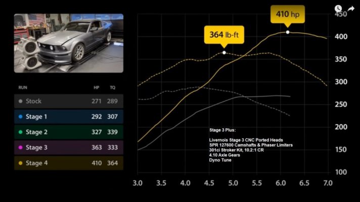

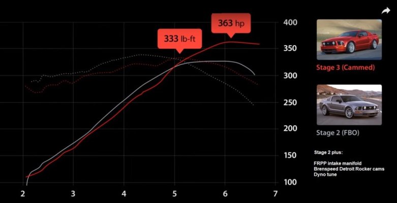

It's far easier to get 400rwhp NA if you build a 4.9/5.0/5.3 stroker but the cost can be prohibitive. If you're nevertheless inspired to take that route, check out YouTuber Four Eyes build of his 08 GT (see images below). You can also check out these pages from my site:

You should check out Four Eyes on youtube, he's doing a series where he took a hist stock '06 GT and upgraded it in stages, with his N/A setup being in the neighborhood of what Dallas posted and makes ~ 410 RHWP. It's a pretty good series, it really shows how much $$$ you can put into an N/A setup. (he's going boosted next)
