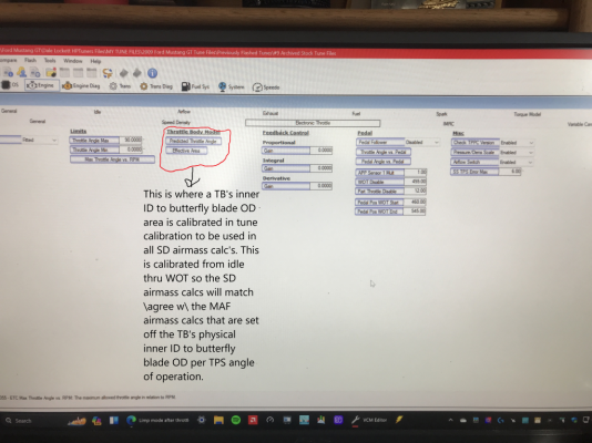

Don't take this the wrong way.......but as for this statement......1.) if what you're implying is if you install a different TB from the 1 currently installed & the replacement is the exact same sized part, then this is correct since the replacement part's PTA\EA effective area hasn't changed thus no issue within the tune calibration.
But 2.) if you're implying that 1 can install a different TB from the 1 currently installed & the replacement part is either smaller or larger in size than the 1 being replaced, then this is incorrect & the physically smaller\larger TB needs to be properly recalibrated\updated in the tune calibration for the ECU to correctly make all predictive SD airmass calcs to accurately match up to the ECU reactive MAF airmass calcs that are generated off the smaller\larger TB's physical inner ID to butterfly blade OD effective area per every degree of TPS angle change from initial startup thru idle thru WOT. Then make sure that the TPS output voltages are within spec range (1.16v thru 1.23v) w\ TB powered up during KOEO.
If this isn't done, then the ECU airmass modeling between the ECU's predictive SD airmass calcs & ECU's reactive MAF airmass calcs will be off thus can cause a lot of tuning issues up to & including emissions.
This is the correct method if the replacement TB is smaller\larger than the 1 being replaced that is also accounted for in the tune.
I'm assuming that you meant #1 but IMHO your statement was too vague thus could be taken in the wrong context is why I responded here.
You'd be amazed at how many folks get this wrong..............up to & including a fair number of tuners.
FYI...........................
