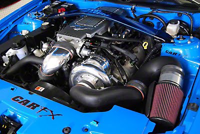

I recently purchased the Paxton Novi 1200 Supercharger for 2006 Mustang GT. Who has experience with this system? I would like to know if there's anything else I should add to it for best performance or is a must have for the build?
Here's what's included in the system.
  • NOVI 1200SL gear driven centrifugal supercharger with drive pulley
  • Bypass valve
  • MAF Housing
  • Piping
  • Couplers
  • Air filter
  • Brackets
  • Hardware
