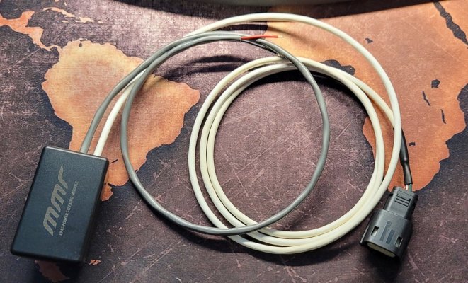

In case anyone's wondering, this is what the MMR "kit" looks like. It really is just a switched 12v source and then the connection to the rack itself, no other wires. Apparently the only thing that comes from the CAN bus is the rights of activation from the machine b*tch living in the ECU. From my understanding this device simply does the same thing without having to splice the CAN harness at the ODB port. The MMR box has a wifi receiver so you can connect to it and do things.
