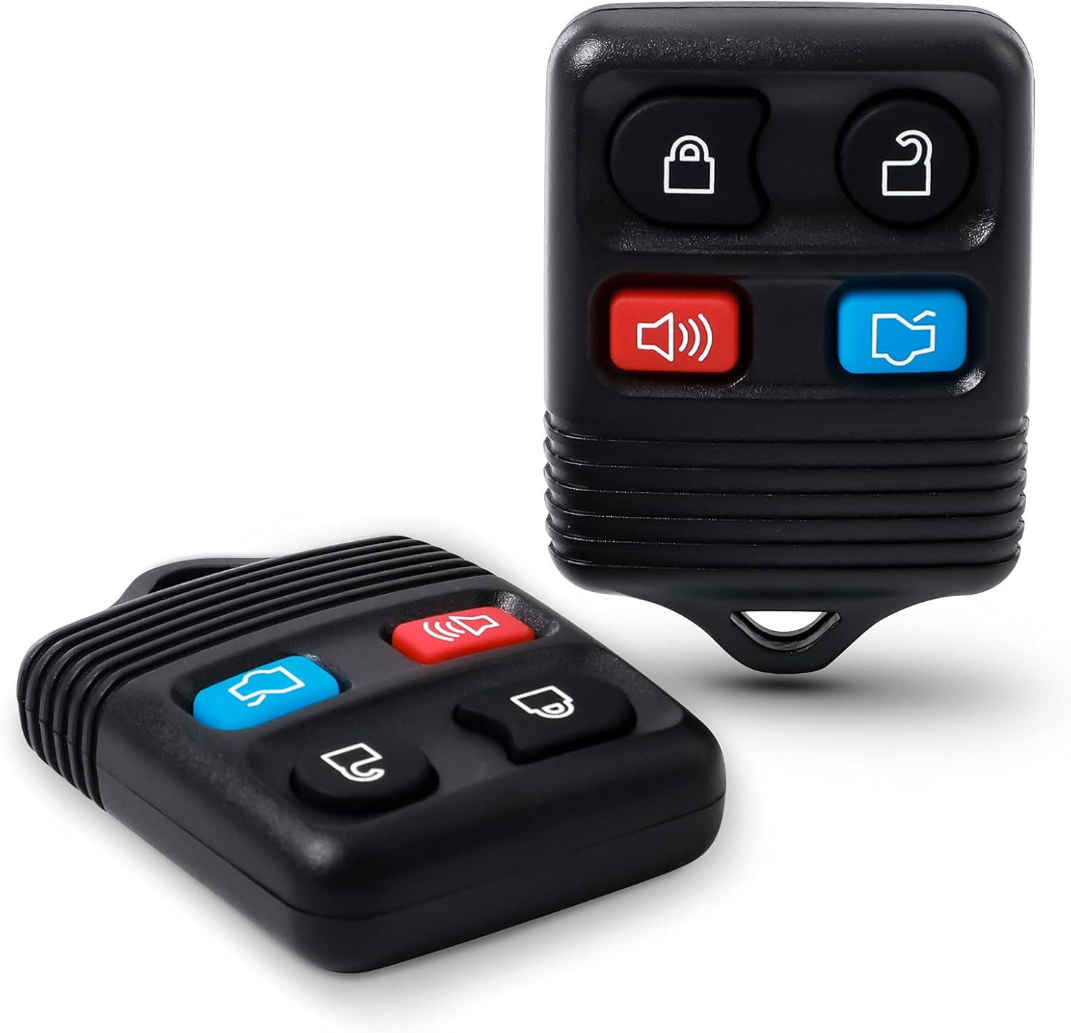

My buttons went bad on my fob years ago. I programmed these to replace them. 2 for $10 on Amazon.
https://www.amazon.com/gp/product/B073W8MTB9/ref=ppx_yo_dt_b_search_asin_title?ie=UTF8&th=1

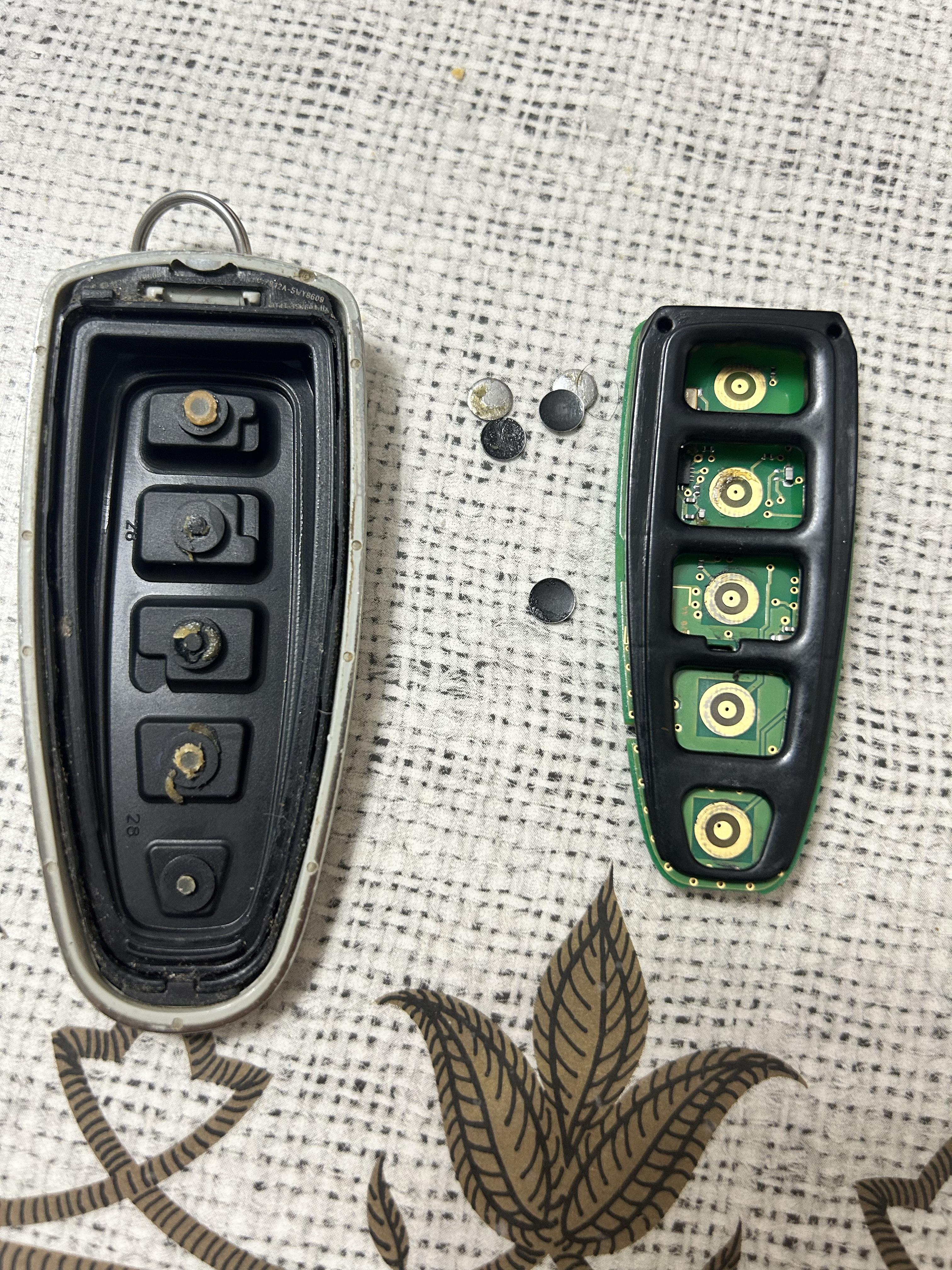

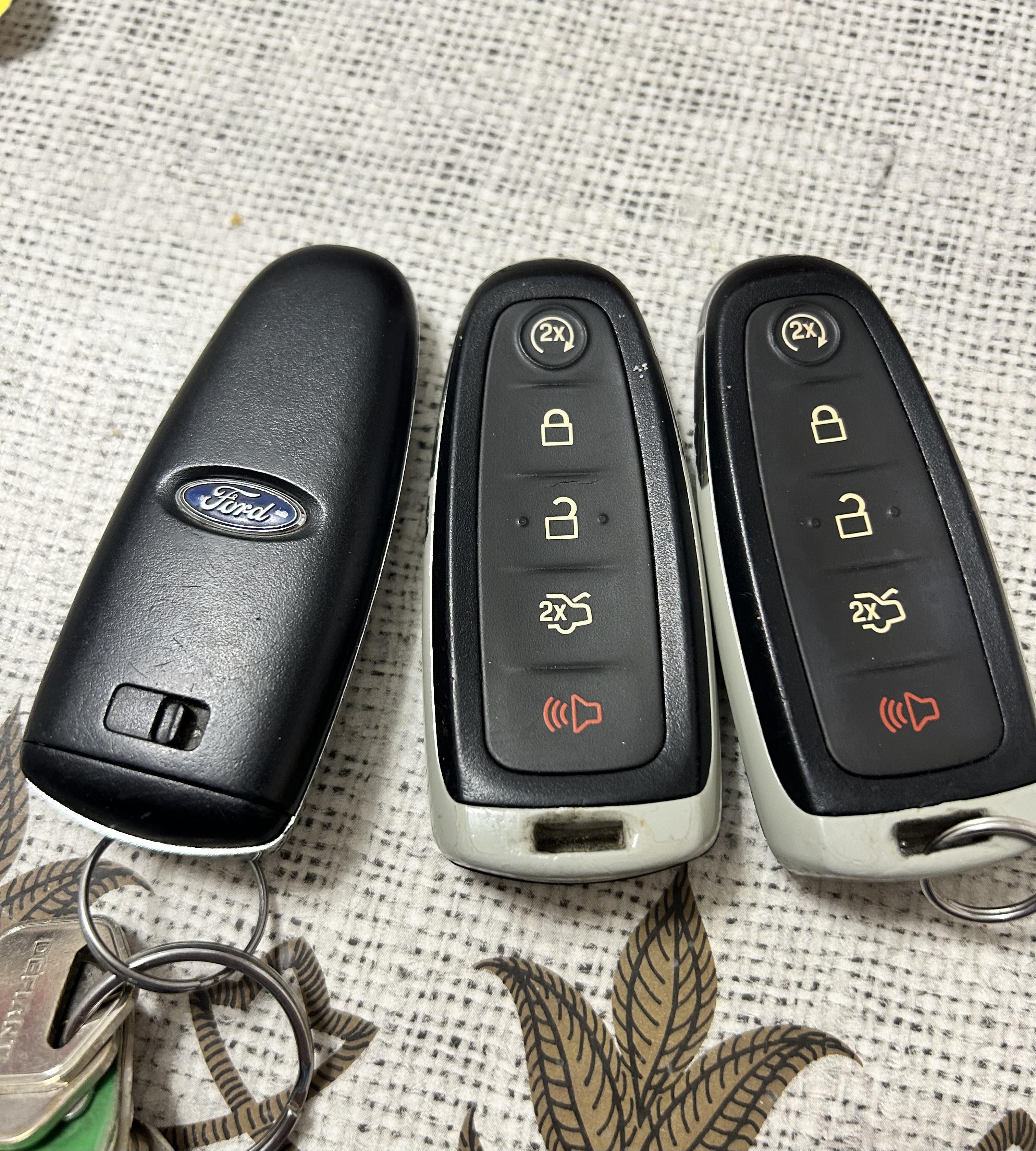

I recently had both key fobs for my 2012 Edge Sport go wonky (at the same time!)
The rear gate would randomly open, it would lock, unlock, etc when the key was in my pocket. At first I thought the sensor in the vehicle was bad because both fobs started acting up. I removed the batteries and used the door keypad to lock/unlock.
As I looked for replacements I saw one for -$10 instead of the $35-$40 the others were. It turns out it was the shell only with new metallic discs on the buttons. (I noticed that these were slipping off the internal button and contacting the circuit board).
I was able to place my existing circuit board into the new front case and use the OEM back case (to keep my Ford logo) and, bingo! Problem solved.
I will order another one for the second fob today.
