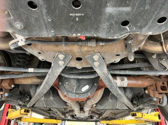

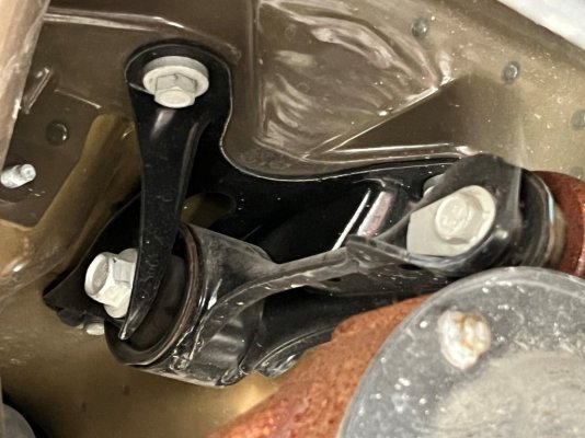

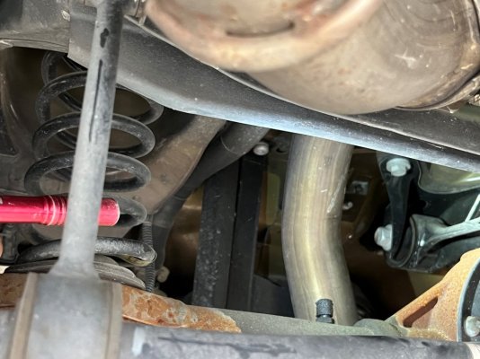

Here are some photo's of the areas we looked at. It appears some of the parts are newer than the others.
I've gone to the same mechanic for 24 years and have a lot of confidence in him. I've watched him restore cars and build racecars so I I'm confident he knows cars. He didn't find anything underneath. He's not a Mustang expert and suggested I post on the Mustang sites and see if we get any input.

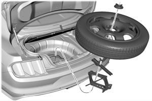

Yep, Just open the truck and lift up the cargo liner (carpet) should be a wood like cover lift it out and there you are - A spare. Sounds like stuff came loose to me also. I know mine did.

Thanks guys. Rocknrod thanks for the drawing. When I hear the noise, I can just visualize that the jack is bouncing around between the flooring and the tire.

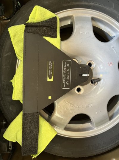

Culprit found. Problem was solved yesterday at the tire shop. I knew the spare was tight but took the car to the shop to have them take the spare out and see if the jack was loose. As they were doing that the manager said I think it's that triangle piece that holds the jack handle and funnel. Put the rags under it for a temporary fix. (photo attached) no more rattling or heavy thump going over bumps on the way home, I've ordered a piece of Styrofoam to put over for a long-term fix.

This turned out to be a simple fix. Either a previous owner, tire shop, or mechanic had failed to put the black plastic piece on the bolt. I Took it to town yesterday, towels and rags only, at that time. Not a peep out of the trunk. Mustangs that have the tire set up my 2012 has must be sure that plastic piece is in place. In my case the bolt had gone through the lower-level cover (particle board?) and was pushing into the carpet making a hole about the size of a nickel. Last night, in addition to the rags I put a larger plastic (spray can paint lid) on top of the Ford plastic piece. This cap is about twice the size of a silver dollar. The beauty of this cap is its outer edge is about 1&1/2 inches deep and has an inside edge that protected the spray nozzle on the can. Fits on the Ford part nicely. It's a little bigger than the head on the Ford piece and no way it can slip off. This gives sufficient support to the area around the hole in the particle board.
Thanks to all of you who had suggestions and ideas. Hopefully, my write up make sense to those having a similar problem.
