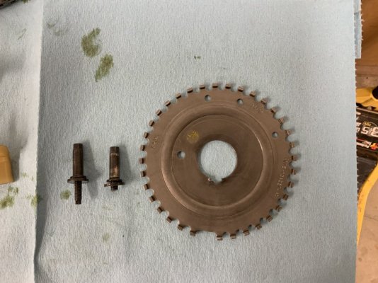

I believe these timing components were damaged from using a two step rev limiter. Stage, push clutch pedal to floor, tranny in first, throttle pedal to floor and rpm bouncing off the first setting of the rev limiter. Let the clutch out and YEE-HAA.
