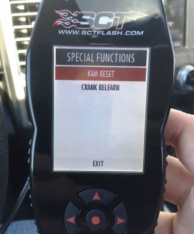

A few weeks ago I cleaned my throttle body. Went pretty smooth. It wasn't that dirty so some time in it's lifetime it had probably been done. Ever since then my car has been slower returning to idle. In the last few days it was hanging about 1100 rpm until the car came to a complete stop. I checked to see if the PCV lines were correctly attached and they were. So I did a little reading and found some threads that said a KAM reset after doing anything to the intake tract was useful. Some even said they do it after every other tank of fuel! I did it this morning and after a short drive everything was back to normal. Good times!

KAM stands for Keep Alive Memory and is where all the learned adjustments that the computer has made over time. Most of these are settings for fuel trims and information to help with idle stability. You would want to reset the KAM after fixing a mechanical issue like an air leak or a bad tank of gas. This functions like reloading the tune file but you do not have to go through the whole process.
So....
Literally reload my current tune?

No, literally reset the saved values that the computer has ”Fine Tuned” previously, and stored.
It resets to default values, your computer can start fine tuning from scratch (desirable) as opposed to the slow process of trying to make changes to the previous fine tuning (undesirable).
(Optional)
If you WANT to reload your tune, you can do that too, but it’s unnecessary.
