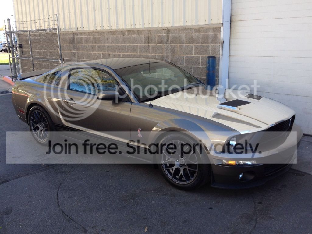

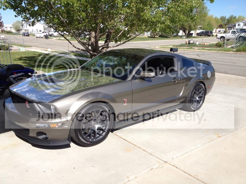

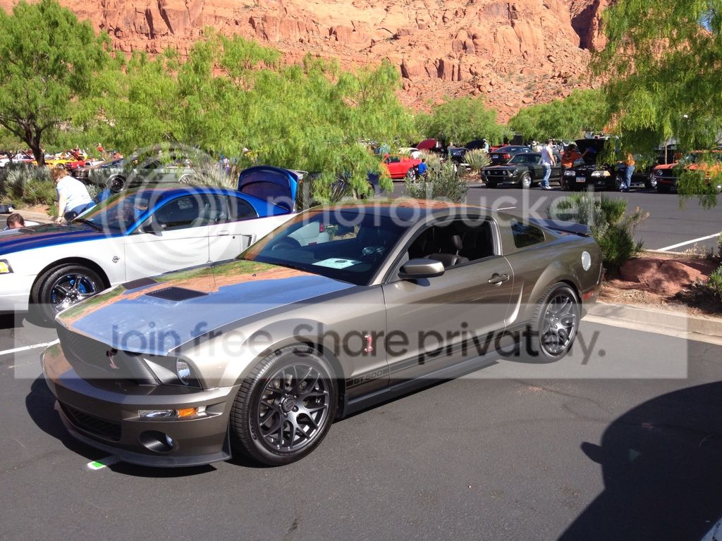

Just incase anyone else comes along with the same question, it is a confirmed fit with up to 295/40/18 tires and -2" drop.
Quote from 19COBRA93:
"They're the standard 05-13 offset on AM's site. No fitment issues at all, no spacers, they clear the Brembos no problem. They fit perfectly. I don't know why they list them as rear only. The 18x10's fit the front flawlessly.
I'm running 295-40-18 Falken Azenis all the way around right now, but in some of those pics I was running 285-40-18 Goodyear F1 Supercar's (stock GT500 rears) all the way around. No fitment issues at all with either set. I run the Falkens during the summer, and the Goodyears during the winter."
Also a quote from Dan Bailer from American Muscle:
"We don't recommend 18x10's for the front. However, there is a lot of people running this set up. We don't recommend it for the front in case you run into clearance issues. We're not saying you're going to, but we don't want to recommend it in-case you do.
I don't see a problem with it personally. It sounds like there is some great advice floating around this thread also. If you follow the steps to make sure you won't run into any clearance issues, you should be in good shape!
Hope this helps. Let us know if we can be of any further assistance!
-Dan"
