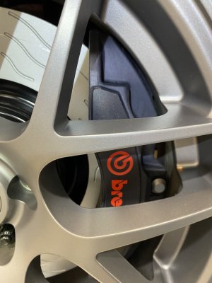

Just wanted to update this with some information that others may find useful. I have the 19x8.5 and 19x10 AMR wheel package and these calipers will not clear the wheels. Depth wise, everything looks great. The issue is the diameter on the wheel at the end of the calipers. Any suggestions on what to do, other than larger wheels.
Edit: I know the caliper is on the wrong side and bleeders should be facing up. I had the other caliper on and had the same result, I only tried this to see if there was a difference.

If you want to run those wheels you're going to have to figure out what size spacer will give 2-3mm clearance between the caliper & wheel (I ran an 8mm spacer w/one set of wheels; and a 12mm w/another). You'll also need to decide whether to use extended studs or extended lugs. I used extended lugs (easier) but would recommend extended studs in most cases (which is a better/ stronger setup IMO). Just ensure the spacer is appropriate for the car (5 x 114.3 w/70.5 CB & hubcentric lip).
Hubcentric spacers
Extended lugs
I don't use a spacer these days because I found a set of wheels with the right offset that fit without spacers but still have them in case I want to use the other wheels in the future.

I guess the part that confuses me is I’m not sure what good a wheel spacer will do for me. Even if I pull the wheel away, it’s dragging on the inside of the wheel. I believe I need a larger diameter. There’s plenty of depth to clear the front side of the caliper. It’s hitting on the ID of my wheel.
