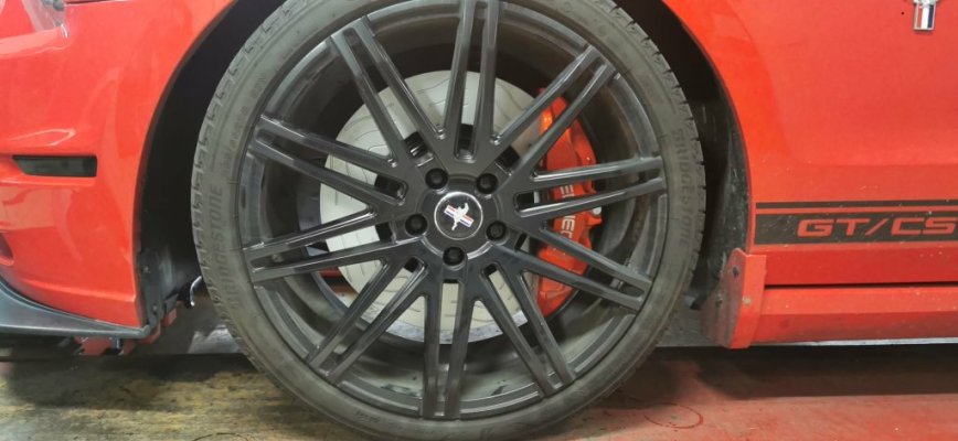

Try putting the rear wheel to the front. The rears are wider and have a different offset. If anything you could go to the dealership and buy 2 rears so that you’d have a square setup. Unless you want staggered.
My rear tires are 275, the fronts are 255s. I guess I would have to get new tires as well.
Yes that too. Try the swap of rears to front and see how it goes. I guess you like the wheels so not really much options.

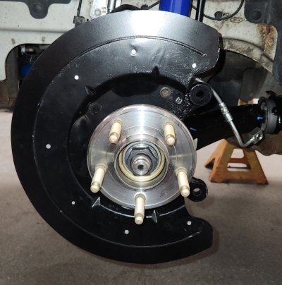

The only other thing is that I don’t know why my wheels hit the studs even after adding spacers that clear the brake calipers.

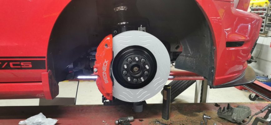

Ford did use a larger master with the 6 piston brakes on S550's. I did on a thread on it a while back here.
https://trackmustangsonline.com/threads/s550-pp-master-on-s197.14230/
This is my concern as well with the six piston setup. Significantly more fluid is needed to move those six pistons. Seems the master cylinder would need to have greater fluid moving capacity.
I did a four piston upgrade on my 14 GT and am very impressed with the much improved braking. Six piston upgrade for a street car is massive overkill and possibly dangerous on a track car with the stock S197 master cylinder.

You need the 14" rotors for the four piston calipers, not the 13/14 GT500 rotors.

Hey, thanks - so the spacing on the s550 rotors is different it wasnt designed for s197 platform, so you will need washers to push the caliper a bit out so it fits on the rotor and wont rub on it all the time. I dont know the exact spacing because i never tried to put washers on , but i can confirm that it will not fit without those. Gt500 rotors from s197 gt500 are same spacing as our rotors and just larger while being same diameter that 6piston s550 rotors. They dont need any modification and all is plug and play, just go with those
