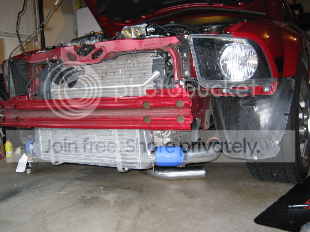

The kit I ordered from cxracing arrived yesterday. Started putting it together last night, did some more today. Now I'm waiting for more parts to arrive so it will be on hold till they get here.
Here's the progress so far:

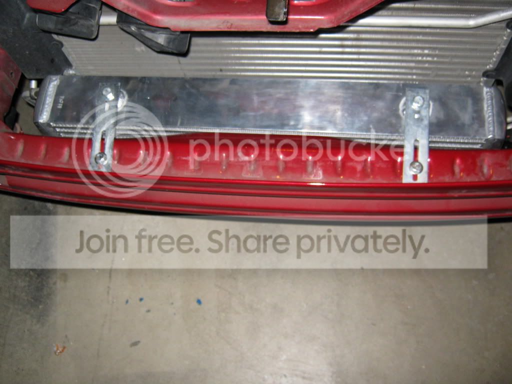

I didn't feel the supplied mounting hardware was stout enough so I bent up a couple of z brackets out of aluminum stock to help support it. Drilled all the way through the bumper and used the same bolts to secure top and bottom brackets.

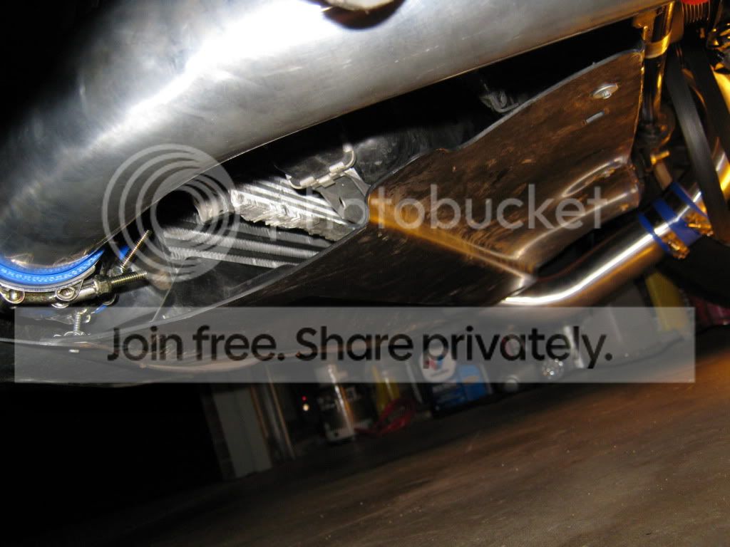

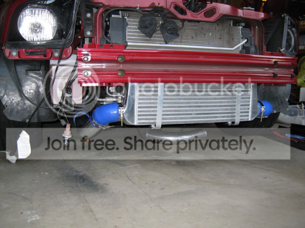

Got the bottom tubes on and in the right spots to get in the engine bay. The passenger side is through and waiting for the tb coupler and associated parts to get here. The driver side will take a little more thought but shouldn't be too big of a deal.
The extra brackets are tweaking the chin spoiler just a little. Everything still went back together without any hacking.
That's as far as I can go until more parts arrive on Friday.

I tried to research sizing air to air intercoolers prior to the purchase but wasn't too sucessful. I went with a 31 x 12 x 3 with 3" tubing. Core size is 24 x 11.75 x 3. If I understood what I read correctly it should support up to 1100 cfm which is more than the throttle body will flow.

Your passenger side pipes look a little low. Be careful... it'll mash the tensioner when you pull into a parking spot and hit one of those curb things.

I hate those curb things. You sound like the voice of experience, lol. There is a plan in place to secure everything once all the parts are in. Clearance is pretty tight, I almost wish I went with 2.75" tubes instead of 3" for a little more room around the sway bar.
