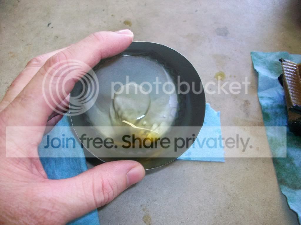

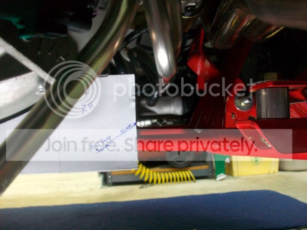

I placed a call to Canton and asked them to take some measurements of the 15-780 pan. I was concerned about the oil temp sensor contacting the automatic transmission cooler lines. With the information they provided I made this template
Then test fit the template to the vehicle - sorry for the crappy picture. From the template, I also determined the OEM pan is approx. .200" deeper than the Canton pan.
As you can see the relocation of the oil temp sensor is a non issue

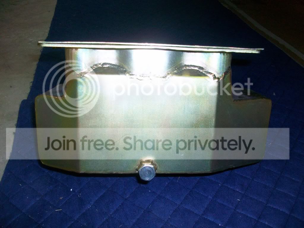

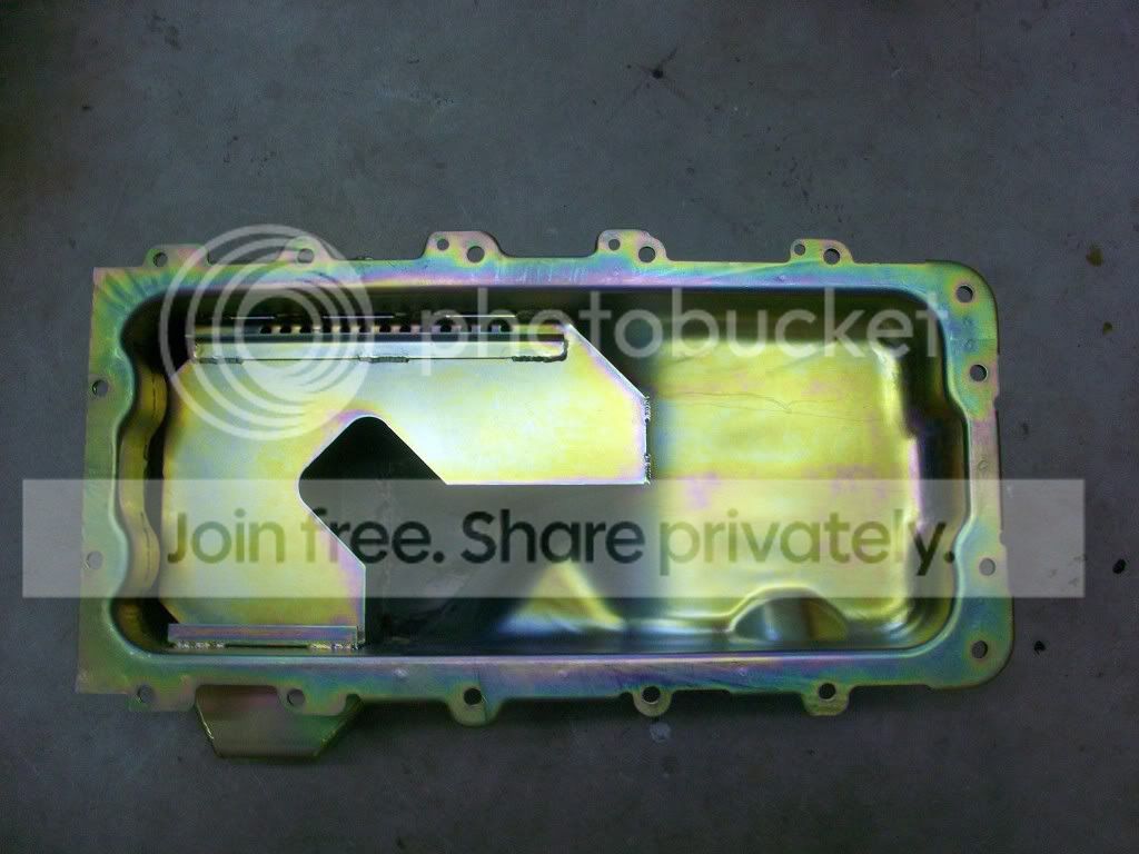

Here's a couple of pictures of the pan
Pan includes a 1/2"-20 magnetic drain plug.
Once I have the OEM pan removed I will compare the excat depth of the OEM pan to the depth of the Canton pan. I want to make sure the oil pump pickup tube doesn't fit too closely to the bottom of the pan. Canton recommends 5/16" - 3/8" up to .50" clearance.
The oil capacity with this new pan, including the OEM oil filter, should be about 7.5 qts which equates to a 25% increase in oil capacity over the OEM pan.

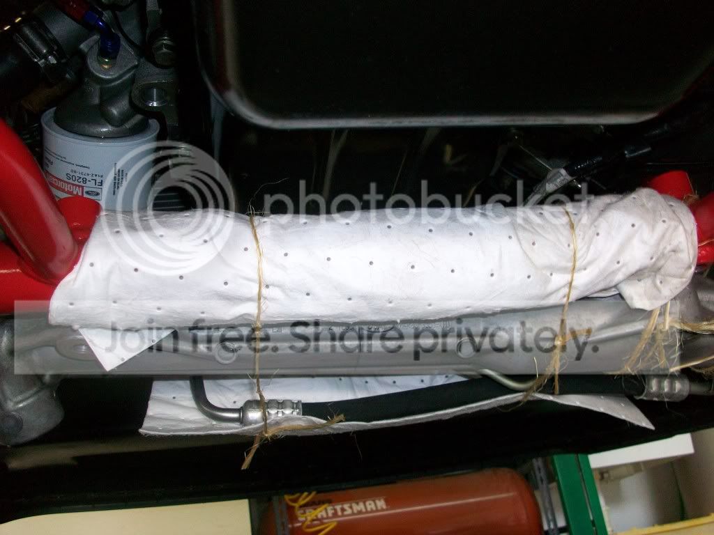

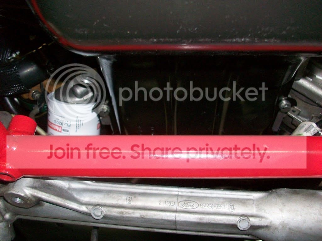

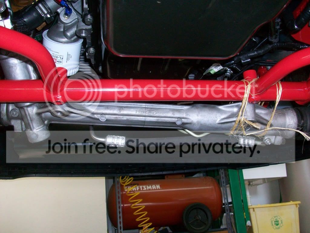

Time to remove the oil pan. Now as you've already seen I have a BMR K-Member. However, it has 1/2" lowered mounts as I'm running a Saleen S/C. I was concerned if there would still be enough clearance to remove the oil pan with this K-Member. So first order of business was to unbolt the steering shaft and the (2) rack mounting bolts.
No need to completely remove the steering rack, just lower and secure to the K-Member
wrapped the K-Member in an oil absorbent diaper - no need to scratch the K-Member
Now for the moment of truth, I'm pleased to report the OEM oil pan can be removed even with the lowered mounts

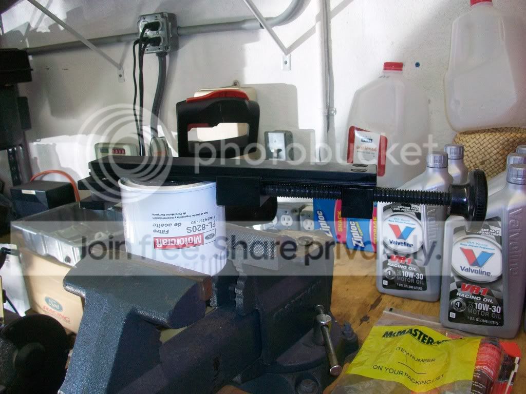

Since the oil will be replaced, this is a good time to remove and cut open the oil filter, just to check the health of the engine. Filter cutter makes this a breeze.
Everything looks excellent

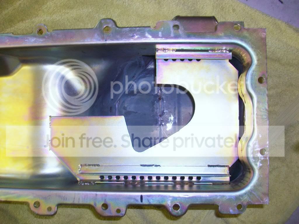

So after measuring, remeasuring and measuring again, I have determined some very important dimensions when using this pan.
Those of you that have installed this pan or the 15-784 pan may want to pay close attention to this post.
  • This pan is intended to be used in combination with Canton's screen windage tray. Their windage tray mounts between the pan and block unlike the OEM windage tray that mounts to the main caps. Without using their windage tray, the oil pump pickup tube hits the oil pan sump by about 3mm and would starve the engine for oil. This will require the oil pump pickup tube to be modified.
  • Next issue is the engine oil dipstick. The opening in the slosh baffle isn't large enough and the slosh baffle hits the dipstick. Since the dipstick is flexible, when the pan is installed, the slosh baffle just pushes the dipstick up. The end result is the engine oil is overfilled. So after some more measuring, I modified the slosh baffle to clear the dipstick. Now the dipstick no longer hits the slosh baffle. Here's some pictures.
Unmodified slosh baffle
Modified slosh baffle

So after modifying the threaded oil pump pickup tube support spacer (machined .180" off the spacer and installed a shorter M8x1.25x16mm grade 8 bolt and hardened M8 flat washer with blue thread lock to retain the bolt) and the pickup tube suction bell (removed the suction bell, shortened the tube .350" and reinstalled the suction bell), I now have .340" clearance between the suction bell and the bottom of the oil pan.
All "should" be good to go - right?? Not yet. I tried to install the oil pan with the modified pickup tube installed and the suction bell hits the slosh baffle when you try to tip the back of the oil pan up into position. This must be what 08nastygt was referring to in his earlier post. The K-Member to oil pan clearance is not the issue. The problem is the pan is intended to be installed without the transmission in place. This would not be an issue if the transmission wasn't in place as the pan could be slid from the rear toward the front of the engine as it is put into place.
I can only assume Canton did not validate this installation with the engine and transmission in the chassis, if it was validated at all.
Not to be deterred, I took more measurements, remeasured and measured again. I have modified the slosh baffle again to allow the pan to be put into place with the transmission in the chassis. After the modification was made, the edges of the slosh baffle were all carefully deburred and the pan was thoroughly cleaned. Here's some pictures of the modifications required to the slosh baffle:
unmodified slosh baffle
slosh baffle modification #1 required to clear the dipstick
slosh baffle modification #2 required to clear the suction bell during oil pan installation with the transmission in place
I should be test fitting this modified oil pan this afternoon. Hopefully all will be good to go. Will post the results.
By now this oil pan installation has become a battle of wills. I'm not frustrated yet, but getting very close and that is when stupid mistakes happen. Fortunately I have this whole week off of work, so when frustration sets in, I can walk away and come back with a clear head.
For those of you considering this Canton 15-780 oil pan installation, if you read this thread and modify the pan as previously stated this installation will be trouble free.
PS: I made a template of the modified slosh baffle so if I have to do this on another vehicle I won't have to reinvent the wheel.
