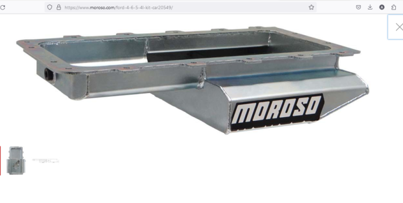

When I look at the shallow pans from Moroso and Champ they have a horizontal section above the hinged baffles with drainage at the edges and pickup hole and apparently they get the oil to the pickup ok. My proposed baffle would be edge to edge inside the widened portion of the pan so it does present a bigger horizontal area than the moroso pan but I would include drainage holes at the area of the head drainage along with edge and pickup hole cavity, so I hope drainback would be ok.
By placing this horizontal baffle at the correct depth in the pan it would act as anti-climb during cornering, and keep more oil in the pickup area. The correct depth would be the depth at the running oil level, so if 2 qts are in the engine that leaves 4.5 in the pan and I would set the baffle at the corresponding height above to pan bottom. That means the baffle should be positioned 1 7/8" above the bottom of the pan. Which incidentally appears to be the Moroso height of the horizontal section.
I have attached a photo of the Moroso pan which seems to be the best on the market but out of stock for 4.6 as the Coyote is the choice these days. I notice the Moroso pan is angled down at the driver side back corner, does anyone know why?
Thanks for all the in put, Earl

I would hope that moroso has done their testing but I would still like to see a more direct path to the bottom, especially along the sides. Don't forget that you will need to shorten the oil pick up tube to match the pan. The cut out may be for steering shaft clearance.

Thanks for the input, yes the pickup has to be shortened and that will be done once the welding is complete. Welding is underway, we are doing some welding and some brazing, will clean the pan with acid and give it a alkali rinse then test for leaks.
The cobra steering shaft is well above the pan so I am still wondering why the angled section.
