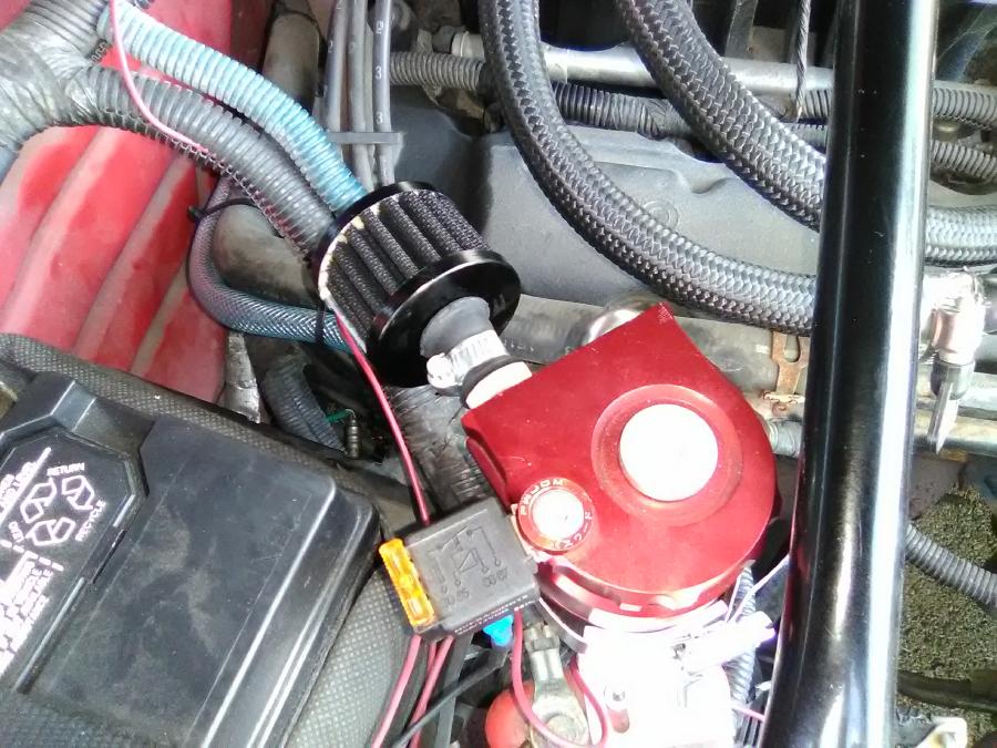

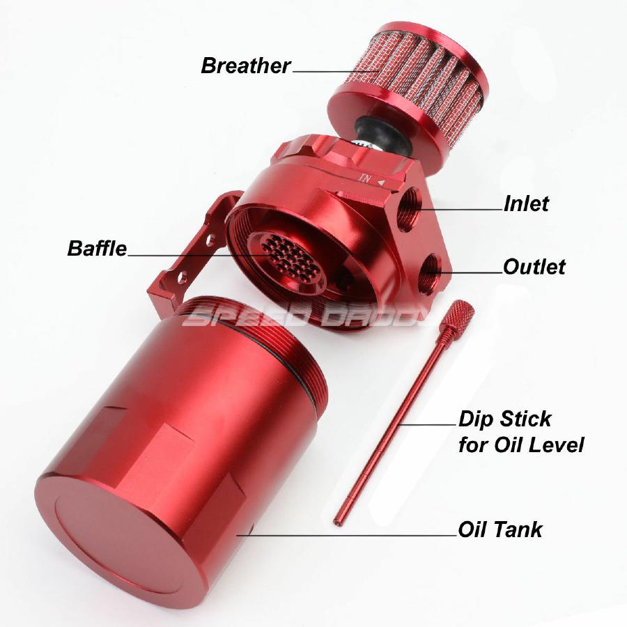

First off, you won't get any blow-by from the driver side valve
cover. It only comes from the Passenger side. You do not need
a three-way for that. All you will need is one on the passenger
side. If you must, use a separate one on the driver side, but it
will never get oil in it.
These are $25.00 or so on eBay. The breather opening will be capped, so it stays that way.
They come ins Red, Blue, black, Silver. I got a red one and a black one. Black is is the oil
catch, RED is the trans vent.
Oil Catch:
I bought some AN10 line for eBay, 3 feet to be sure I had enough...
5R55S Trans Vent
