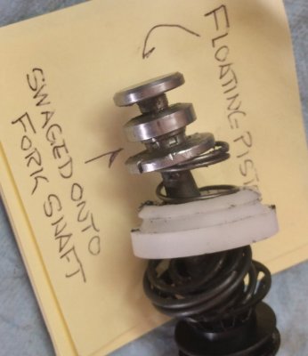

I just bought an S197 brake booster and disassembled it to see if it was possible to replace rubber with delrin. I removed valve assembly and found there is NO rubber between the fork rod and the MC push rod. there is a floating piston swaged to the end of the fork rod that can swivel but has no linear travel. The piston fits into the diaphram plate to which the MC piston is hard mounted. In effect the MC push rod is connected to the brake pedal with a solid mechanical connection. In conclussion there is nothing to be gained in brake travel by messing with brake boosterBB15.jpg BB14.jpg

I just bought an S197 brake booster and disassembled it to see if it was possible to replace rubber with delrin. I removed valve assembly and found there is NO rubber between the fork rod and the MC push rod. there is a floating piston swaged to the end of the fork rod that can swivel but has no linear travel. The piston fits into the diaphram plate to which the MC piston is hard mounted. In effect the MC push rod is connected to the brake pedal with a solid mechanical connection. In conclussion there is nothing to be gained in brake travel by messing with brake boosterView attachment 87196 View attachment 87195

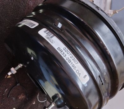

My 2014 (which I bought new, so am original owner) had this,
I tapped the booster rod and made it adjustable (and longer).
So you can't make a blanket statement like that. It could have been an auto only or 13/14 thing.
You also seem to be messing with the wrong end. What does the front of booster look like. Does it have this plastic mess inside, with the small metal "pin". Does your booster rod look like above? You can see center there, where my booster rod with rubber disk fits over (in front of) the plastic.
