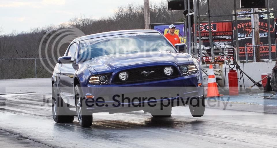

Went back to the track today and the da was a little bit better, same mods and fuel as last track outing.

Getting close- Car was 1 mph faster in the 1/8th this last run but almost 3/4 mph slower in the 1/4 . was there a slight head wind? You said the da was better this last run surprised you didn't break 137mph.
I just looked on drag times and the da was just barely better than before, 1200 on the latest pass and 1450 on the previous best. I got some data logs for the tuner on the previous best and used a revised tune for the most recent best. I guess I can attribute the gains to the tune rather than the da, I was going by what some guys had told me at the track regarding the da on this last trip.

What are your shift points set at?
I think the goal is 7-7100, on the logs form the previous best 1-2 was a little over 6000, 2-3 was just under 7100, and 3-4 was at 7400. The tuner moved 1-2 up, left 2-3 alone, and lowered the 3-4. I did not log on the most recent track trip but it did go close to a tenth faster in almost identical da.

The 1-2 seems very low to me. You want the car to stay in its powerband and its losing momentum shifting so early.

I agree it's definitely not optimal however it's not as bad as it would be on a N/A car.
Just fixing the shift points under the same conditions should net a 9.
Yep im loving shifting at 7800 and 8000 respectively.

Cams and more RPM FTW!
Although my cams are not significantly larger than 11-14, my car loves revving to 8300-8500.
I am anxious to see what the new patch will do for the TVS crowd on 11-14 cars, being able to take 1st gear to 8K+

RPM is your friend! Easy 9 next time out with 1st shifting later. Nice progress.
