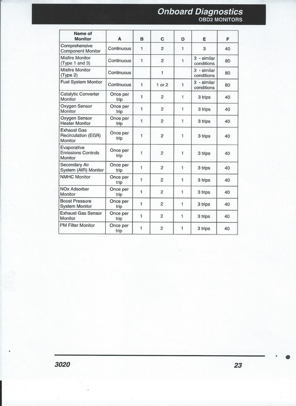

.........Info I came across while trying to reset my monitors:
Some things to consider, - cold starts matter more than miles driven, some monitors can't reset till after others reset before them. One posting suggested 1/4 tank or less of gas. It's a PIA, but you'll get through it,.............good luck..
1/4 tank of gas or less will keep the Evap monitor from running, and only the Evap monitor.
On my 2013, the Catalyst and O2 monitors will NOT run until the Evap monitor completes.

I had Kooks high flow cats on my 11, they threw codes, tuner turned the 02's off, ( that was 9 years ago ). When I had to go to inspection, ( N.J. ) Kooks " green " cats got me through with no issues.
That manual says compression ignition, wondering if that manual is for diesels or if it's just a general one for all vehicles :dunno:
