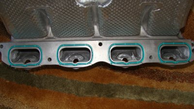

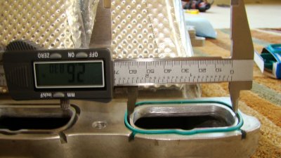

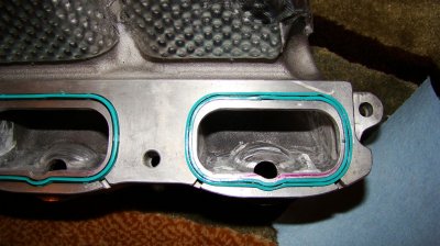

I wanted to post this for those that may some day find out they are one of the select Livernois customers and cant afford to shell out the money to replace their stage 3 cylinder heads. This is the idea I came up with and am going to give it a shot:

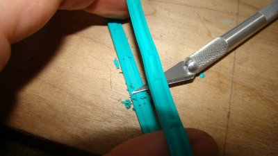

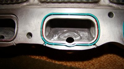

The OEM gaskets have retaining nipples and a ring that runs around the inner and outer side walls. These nipples lock the gasket in place during installation and center it in the groove. Problems start with the Livenois cylinder head intake ports which are cut to 2.6605" (as I have previously stated all measurements are as exact as possible). The inner edge of the OEM gasket installed in the manifold measured 2.6360". I needed to come up with away to push the long side inner edges of the gasket back about .0245" to at least be even with the Livernois over cut intake ports.

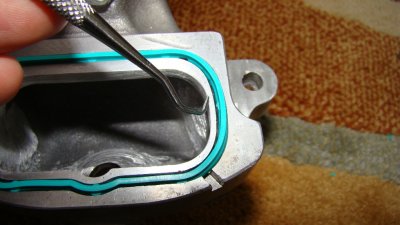

I tried a couple of ideas before finally coming up with this:
What I did was to shave of the retaining nipples on the back sides of the gasket in the corners where I needed to push them back so they can have a chance to seal against the over cut Livernois cylinder heads. I also poured a few beads of Permatex "The Right Stuff" almost like o-ring cord. Once dry I cut them down so I could use them as a wedge to force the gasket back into the wall of the groove.
With the gasket installed in the manifold, I used a dental tool to push the Permatex between the inner edge of the machined groove and the gasket. This was only done in the corners since I learned from prior attempts that pushing the entire gasket back really changed its "squishability".
This solution should only need to keep the gasket set back long enough to install and torque down. If the small amount of Permatex does eventually get sucked into the combustion chamber it should just burn up or be spit out no problem.
Since the manifold was off I went ahead and tried to do a little "port matching". I also cleaned up a lot of the rough casting in the transitions. Not sure if this will really make a significant difference but I enjoyed doing it if nothing else. You can probably also see in a couple of the pics I wrapped the lower exterior portion of the manifold in a heat shield to try and reduce heat soak.
With a little luck, which I could really use at this point, this should hold until a more permanent fix is found.
