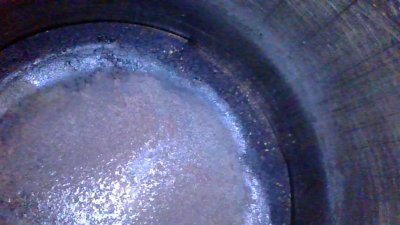

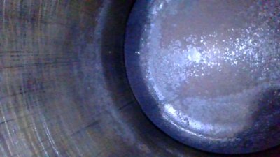

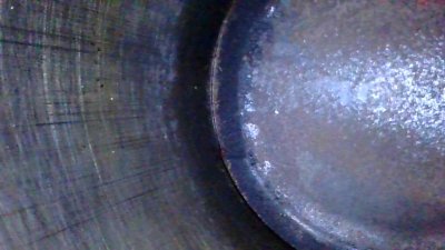

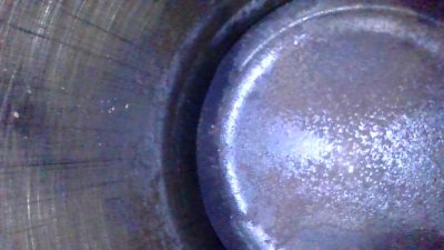

Got bored so swapped out plugs, did compression/leak down and played with the new borescope which is not top quality and couldn't get pictures of the valves. But does have a side camera and have close ups of the pistons. Unfortunately my lack of experience limits my interpretation on what I see in the pics.
Engine is a Livernois 298ci Short Block Stroker (Mahle pistons) 9:7:1 compression with 93K. Compression and leak down seem good. I have more pictures of each cylinder but didn't want to post too many pictures. How does this look to you guys?
Cyl 1
Cyl 2
Cyl 3
Cyl 4
Cyl 5
Cyl 6
Cyl 7
Cyl 8

The dark, vertical lines in cylinders 7 and 8 don't seem normal to me, but I guess they are since they are in all cylinders to some degree. You can still see the bore crosshatch, but it almost seems like something got stuck between the rings and scraped up and down for some time to create those lines. I'm probably wrong, but that's what I thought.
Very little carbon buildup for and engine with 93K so you must use quality gasoline yeah?

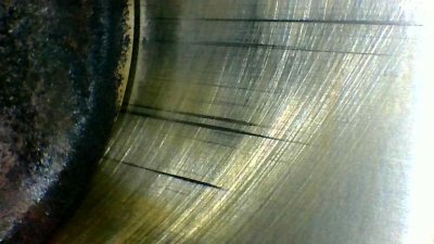

These are pics with the side camera of 7 and 8. The lines concern me as well, but they are similar in all 8 cylinders. Wonder if it's carbon vs. actual scrapes. And yes, only use 93 octane from Exxon.
Cyl 7
Cyl 8

Yeah, what you said about carbon makes sense. If it was something stuck between the rings then it would have gouged it and that's not what I see here.

You can get this with overheating or bent rods. No machine shop will let you get away without a rebore.

If those vertical marks line up with the piston skirts, That looks like the results of a thermostat that is too cold or running the engine hard before it has fully warmed up.

Stock T-Stat and I always make sure the motor is up to temp before getting on it. It has overheated a couple of times due to fan or water pump failure but I've caught it right away and shut down...not that it wouldn't have caused issues, but none that have been apparent. Car runs perfect, just trying to keep learning and those lines in all the cylinders are worth asking about.

Every engine i have ever opened up had those marks. It is the skirts on the pistons that make them. I doubt if you pulled the head that you could even feel them or measure them with a mic.

E9D9AB50-DEE4-46DE-8AF0-B038ECD0DBBD.jpeg Scuffing like that is not normal, especially if it was bored and each piston bore was honed to fit each piston.
Are the witness marks on the thrust side of the bore or both sides of the bore? So, for me either the pistons weren’t fitted to each bore, or no deck plate was used when boring or possibly rig gap wasn’t where it should have been, but the marks are not a good sign. How many miles do you have on the engine since it was built.

I've seen those marks on a borescope only for them to practically disappear once the cylinder head is off.
Also, the skirt design is different on a mod motor than a windsor so apples to oranges as a comparison. Piston scuffing is very common in mod motors.

Very tight P to B on some mod motors. Mine was not! I had one hole with such marks, much less crosshatch than I'd seen in other engines all over - but I put it together w/o touching the bores with new OEM type Mahle rings on the stock pistons and it is the best engine I've ever built. The oil stays CLEAN, tons of power, no blowby.

Motor has 93K miles and about 200 1/4 mile passes. Built and bought straight from Livernois. The marks are consistent around all 8 cylinders. I know the pics are crappy, but they seem to be less scuff marks than they are deposits. Some have even faded/cleaned away with no effect on the crosshatch. Maybe I'll send the pics to Livernois and see what they say. Once again, this is only an inquiry/learning post vs. identifying a problem. But if I caught an issue early, even better.

Bore scopes make images look worse then they are. There are tons of papers / journals written on the topic from medical use to automotive. Stick with the leak down test.

Most engines I’ve seen apart have some degree of scuffing on the bores. You have what looks too me like good compression overall but four cylinders have more than 10% leek down. I would run it until it hit 20% leek down.

I would be more concerned with the leakdown%. Even with 93 k and the dragstrip activity that seems excessive. A well built performance engine will have no more than 5% when new, after break-in. The vertical marks can show up in a less than perfect piston/bore fit. And, if the piston fit is less than perfect, the ring seal will be less than perfect too.
