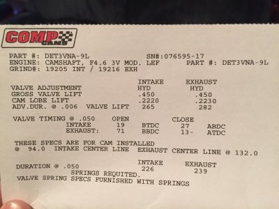

07 Boss
Jan 25, 2009
3,866
992
Sin City
Brenspeed specifically stated with a centri blower I wanted the N/A grind. They said the blower grind was more for the twin screw / roots style blowers
*at least with the Detroit rockers
That just seems odd. Do you have the specs for that cam? Generally when running boost you need a longer exhaust duration relative to an NA cam. Also a wider LSA as now you have pressure pushing air into the cylinder as opposed to drawing it in.
06StangGT
Sep 12, 2017
172
29
Syracuse, NY
Attached should be the specs I received with the cam.
This is the link to the video on Brenspeed's YouTube channel. Right around the 1:00 mark he explains it.
I appreciate your input on all of this.

Brenspeed told me the same thing. I wanted blower cams with my Procharger but they said that I shouldn't use them and that I should go with the N/A cams. I like them and they are way better than the Muther Thumpers that were in it when I got the car. I also feel better knowing that if I decide to remove the Procharger that the cams will still be good to stay in. I just didn't think that they would lower my boost pressure as much as they have. With all the reading I have done, with my 3.70" pulley it should be getting close to 12psi on a stock motor with stock exhaust. With my set up I am getting 8psi of boost at 6000 RPM. I have not dynoed it so I don't know what I am putting to the ground but it is real stout and a lot of fun to drive. The sound of the Detroit Rockers with my exhaust is AWESOME!!
