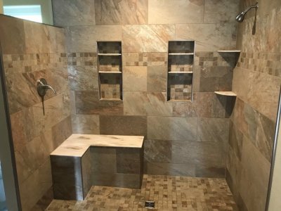

If possible, no construction loan. When we looked at construction loans they were 4.50%. Re financed the house, drew out the money and lowered the house payment $170.00 per month at 2.25%, lower than ordinal loan of 4.75%.
We recently added a handicapped compatible bedroom to our home. (your forever home, ours as well. We've been here 23 years) While neither of us are at that state I am 82 & wife 77. Only had to enlarge one existing door to allow wheelchair access throughout the house.
Everything important on the main floor.
Friend from church built the addition. The good part, he and brother did everything except pour the foundation. They did the framing, drywall, painting and the brother was a real artist when it came to the tile work. The bad part they are about $40,000 over the original quote. I have talked to two retired contractor friends of mine. They tell me my builder is right on track, citing wood has tripled in price as well as other construction increases in our area. We are in a population increase due to people bailing out of some other states.
I'm retired from a utility company. Number one rule. If your going to run any wiring through conduit, go to a larger size to accommodate future wire runs.
Take pictures throughout the construction.
Hope this of some help.
