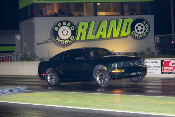

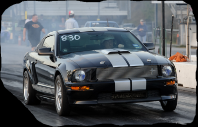

4.10s alone netted a best 13.10, but was a bitch to launch. Most passes had worse 60' than with 3.55. Then I installed LTH's and still just went13.0's. Finally got the smallest slick available in 16" and went 12.54 first pass. After installing fully adjustable dampers, BMR rear upper and lower CA's, and a Triangle Speed tune, I was cutting consistent 1.4 60' and seeing 12.2 time slips. Reason for the small slick was the added peace of mind that I wouldn't break the transmission by leaving on full mash because a big tire would allow it. My launch rpm was set at 3200 IIRC. I was able to make just 8 or so passes with that setup. Ended up moving to where the track is nearly 4 hours away. Which really sucks. Haven't been to a track since. Wheels and tires are now up for sale. Which also sucks.
My home track was close to sea level, so we have really good air when the humidity and heat are down. Which does not suck.
I could occasionally carry the front tires a bit.

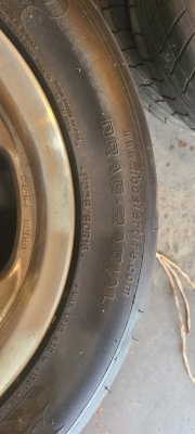

Just a quick update! I finally finally got gears installed after getting the run around by a few shops for months. Hard to find good people, and good people are busy! Anyway, went from a previous best of 2.17, 13.69 at 102 with a tune to 2.09, 13.37 at 104 with the 4.10 gears, skinnies, and drag radials. Keep in mind this was still on the street. I think I'm going to need to hit the track to see 12s. Also the drag radials are too big and tall for the car (305s, and 27.8in tall) I found some shorter 275s I think will help, and now I HAVE to buy them because I got a nail in the sidewall of my drag radial the first drive after the gears! Oh well, win some lose some. I'm definitely happy I went with 4.10s though.
