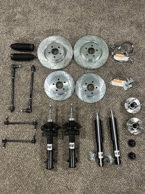

BMR, did 11-14 UCA & bracket (they said it’d fit?), Eibach’s Prokit (scared to do Sportlines with turbo piping)
SR struts & shocks, FRPP wheel bearings, front & rear brake lines, other stuffs Detroit Axle (kinda scared of quality)

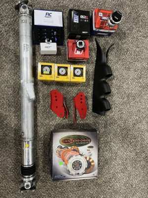

Boost-fuel-oil pressure gauge, FIC 1000, SCT BA 5000, E2 boost controller, Gen V 45mm wastegate

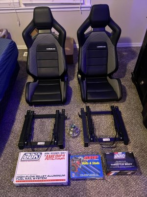

BBK fuel rails (pretty plain looking imo), BBK throttle body (I’ve heard bad about these, anyone have problems with them?), ARP head studs

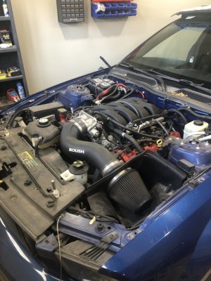

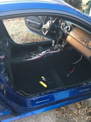

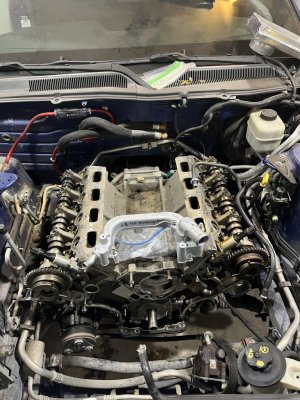

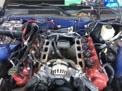

Start, middle, current. I’m thinking about dropping it on the kmember. Want to drop it with motor, tranny, & manifolds still attached…but never done it that way, always used a picker, kinda scared to try and balance the whole thing coming down!! 1 jack, 2 jacks, 3 jacks, more?
Only time I dropped the whole K-member with the engine and tranny we had it on the ground, unhooked everything, lifted the car and rolled it out.
Personally I would send the BBK back and get the FRPP one. Also I see a new water pump. I'm a strong advocate of going electric here. Many advantages and little downside.

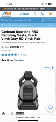

And which seats were those. I like them. I have corbeaus in my car but I really like those. Great choice.
What is it about the BBK or FRPP that’d make you do the swap? Not trying to argue, just trying to foresee problems before they happen ya know! The electric water pump never crossed my mind on this car but I did research it on my 02. Guess cost is main reason I don’t do it now. I’d also be worried about the electrical drain on this setup. Have a pretty good stereo system installed, 3 amps, and plan to run lights when I want them. I still haven’t ordered an alternator bcz I dunno which one will support setup. Been researching adding a 2nd batt or super capacitor….but dunno if that’s even necessary!
Yeah I really like the seats and thanks!!! Can’t wait to see them in there
