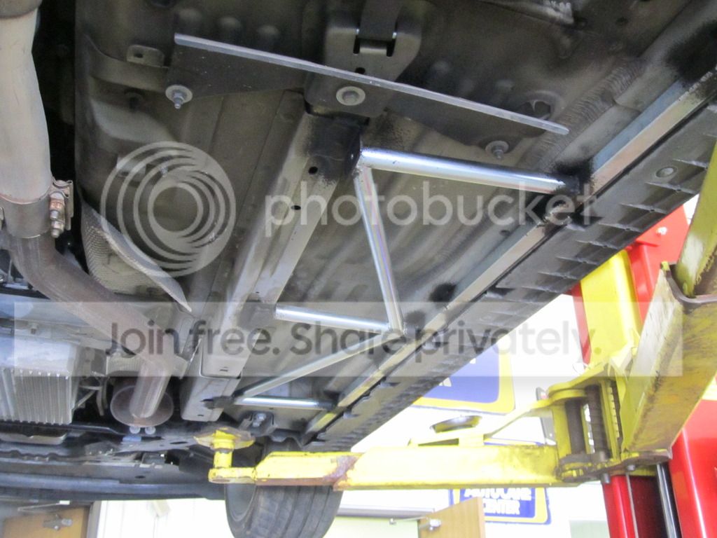

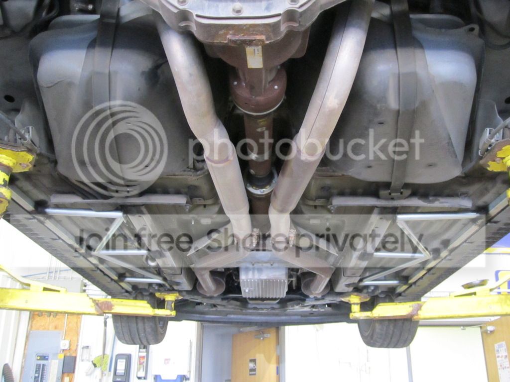

Here is Kenny Brown Matrix Brace and Jacking Rails.

I've seen the installation video. Looks like 1" tubing, and it's all contained in a plane that doesn't look very effective at reducing general chassis warping torsion (what you want to make suspension tuning effective).
I'm not trying to say that it doesn't add any stiffness at all, just that most of the stiffness that it does add isn't in the direction you really want it to be added in if you're truly interested in improving suspension function.
But to go back to what I said in post #7, don't underestimate the 'driver composure' effect. Gaining 2 seconds on a 2.5 mile track means you only have to consistently be about 1.5 mph faster, which is well within the matter of driver confidence.
