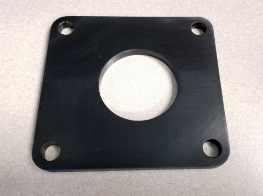

I looked into this some years back, since I feel like the front-end of my '13 sits a little too low.
I forget where exactly I got this pic from, but somebody shared it with me, it's supposed to be a strut spacer meant for the top of the strut, between the top of the strut mount and the bottom of the strut tower.
I never did make any of these for myself, but in theory it should work.

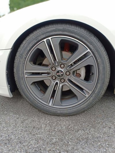

Well thanks guys!! I mounted one front and ran it lock to lock and tried to bounce it (springs too stiff for me to bounce the car) and felt on top of the tire to the fender liner and I have, I believe, sufficient clearance all the way around and on top and will not have to space anything out or up. Next thing will be to mount all, road test and then worry about the TPMS. Maybe if I am unsuccessful a little piece of black electrical tape will mask the light. Again thanks. Oh BTW I used the chrome 5 spoke upside down and kiltered up in back to snug it in the spare tire well and closeted the styrofoam box "spare".
