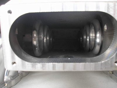

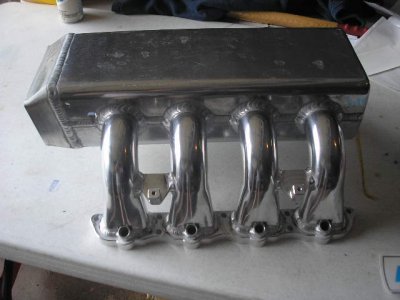

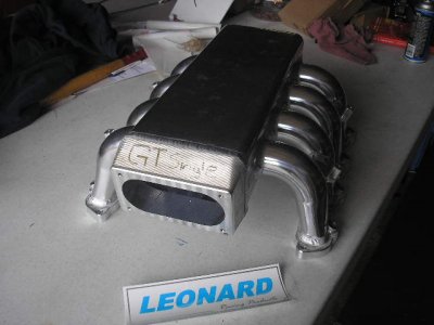

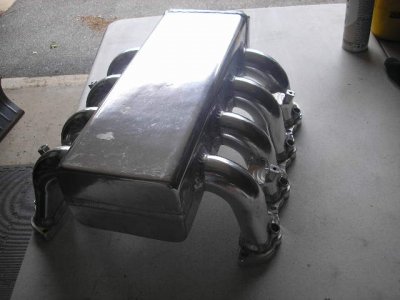

here's the intake from JPC for the 5.4's
it is a very special order item...meaning this is the only one right now but ehy will make it available as an option.
the pictures don't do it justice. it looks damn nice and i haven't even polished it yet.
