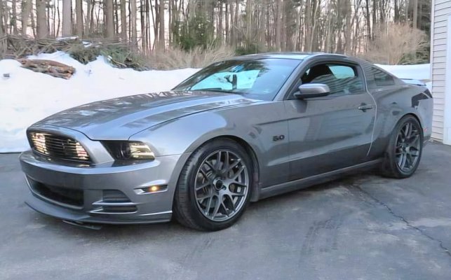

These were the 19x10 fronts on my lowered '13, with 275/40/19 tires.
The rear had 20x10 with 305/35/20 tires, but all the wheels were 48mm offset

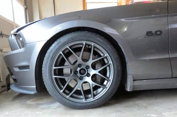

Same wheels as above (19x10) but in silver. Had them on a 14 GT. Listing says for rear only, but they fit fine with the Brembos.
Correct. Those are the wheels I had on my '13 - see the pics above, the 19x10 fit in the front just fine.
They say "rear only" because they don't want people putting them on the front with an oversized tire like a 305 on there, in which case, YES, they'll rub and won't fit.
But with a nice 275/40/19 tire on there, the car will drive and handle great.
