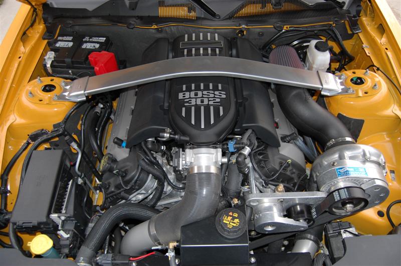

Yeah, the Vortech intake is in a totally different location. Here's mine. You can see the left side capped off and the right has a short hose to the intake that is right next to it.
Even with the car at idle, with my hand I can feel a lot of nearby air being pulled in. I can only imagine what it's like at 7000 rpm and 9.5lbs boost. In other words it's a very significant low pressure space behind the filter literally sucking on the breather.
