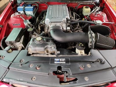

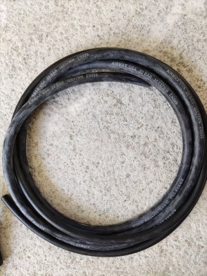

On my 3V, the passenger side catch can has 3/8" hose and the driver's side 5/8". The hose I used is thick rubber that won't collapse under vacuum. IMG_20230624_161812.jpg IMG_20230624_161748.jpg Engine_BBK.jpg
