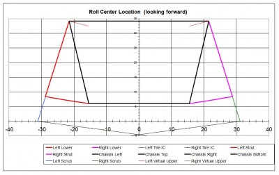

I beg to differ. When you lower car LCA inner pivot is below ball joint. As suspension compresses arc of ball joint travel will add positive camber
Norm Peterson
corner barstool sitter
Feb 5, 2011
3,615
317
RIP - You will be missed
Not necessarily.
Camber only starts going in the positive direction after the LCA arc starts running inside the strut axis - after the LCA makes a 90° angle with the strut axis. That's when it starts pulling the ball joint inward, not before. Based on measurements I made of my car at stock height, that would take over 2.5" of suspension lowering, which would put you almost always on the bump stops . . . meaning excursion into positive camber gain would be minimal anyway.
The strut axis would need to be running essentially vertical as seen in front view for your description to work as you think. But it's sloped inward toward the top at about 15° away from the vertical, has to for tire clearance with any sane MacStrut geometry.
