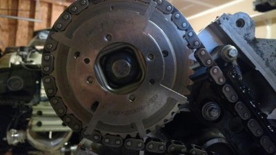

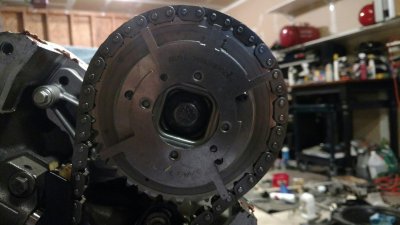

I just looked at pics from when I put the engine back together, before this all started, and I'm 99.9% sure anything is 180* off.
I checked my photos from when I re-timed the system on my teardown, and both of your sides look good to me. The right bank has the three trigger fingers on the wheel pointing down and the the left bank has the three fingers pointing up.
Do the 5.4 chains have double black links on them?
Do you have a pic of the crank gear?
Yup. Just like every other time I've installed it. I've had the teeth jump during initial startup, but have never installed them 180* off.
Yeah, they do. You just put the marks in-between the two. The crank position on the chain still has a single mark.
I thought I did, but I can't seem to find it. Gonna look in my old cell phone pics. I dump those in a "random cell phone pics" folder every few months. But I did that part however the book told me.
