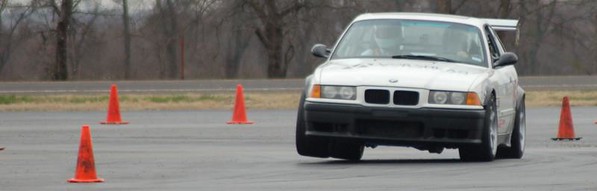

Our first V8 BMW E36 above was a classic case of this. With an H&R front swaybar added, at the next autocross test event (shown above) the car pushed like mad (massive understeer) because it had too much front roll stiffness. It was getting up onto 2 wheels in transitions - too stiff! We took it back to the shop, put it on the lift, unhooked the endlinks, and I could hang my 200 pound body from the end of the swaybar. Wouldn't budge. We spaced the bracket down, ground the bushing a bit, got the bar to pivot freely, and then took it to another event... night and day difference. It was now neutral and the DEATH PUSH went away. No parts changed, not even swaybar settings, just fixed the swaybar pre-load in the mounts.
So look at your swaybars for this "bound up" condition, because it is ALL TOO COMMON. I've probably seen this 50 times in our shop with customer cars. That's something to worry about with swaybars, not their total deletion, good grief. And yes, some of the internet folks that swear their "no swaybar" setups are faster were likely victims of a "stuck" swaybar. Don't let that data confuse you....
