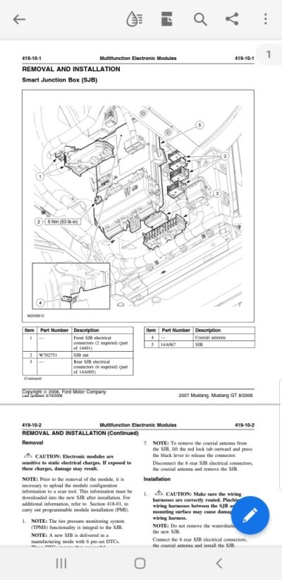

You're getting your SJB wet. Which is the most likely reason why they car is acting like it's possessed. Take out the SJB and dry it off. I would also open it to make sure that there is no corrosion in there. You need to do more then clean out the clogged drains and waterproof the car.
Read this pdf. It will help.
https://drive.google.com/file/d/1QI-yYak90zmaMHGte5QN0ye-FYGzAUAP/view?usp=drivesdk
This attachment... best resource to help you track down leaks. If up front most likely windshield grommets/doors /cowl drains. Regarding the water being hot is that due to leaking coolant or car is in a hot environment. If you're not losing coolant it's not from the heater core. I'd take the passenger seat out; take up the carpet and take it into a car wash. As you go thru check problem areas with a flash light. Should be apparent where it's coming from. In my case found both the windshield grommets and driver/passenger window seals needed to be replaced to take care of the leaks. They're actually easy fixes. Just a bitch determining exactly where it's coming from.
