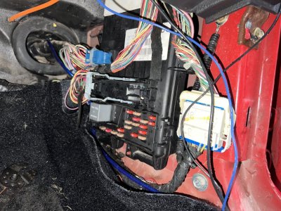

I’ll see your clogged cowl panel vent leaking into the interior through the cabin air filter and raise you a water logged SJB.
Dimontague
Apr 20, 2021
32
Just replaced sjb! Yep, had a flooded pass. Side, repaired, sjb went bad, the remote would not shut off led lites

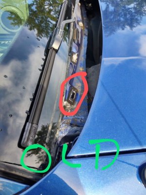

The driver's side cowl drain is almost directly under the windshield wiper motor. Mine had barely anything in it.
Anyway- I've got clear cowl drains, replaced the cowl panel grommets AND replaced the door seals (on the trim piece above the windows- on the body) and I still have water getting into my car. I guess the one good thing is that I pitched all the (water logged) factory sound deadener a couple years ago when I had to fix the floor pan, so at least the water doesn't just sit there forever-it does evaporate after a few days.
You might want to pull out the plastic fender liner on the driver's side and check the condition of the seal between the fender and the door hinge pillar.
