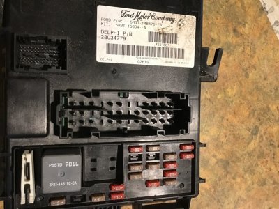

just finished our coyote swap on a 2006 Convert. V6, and no electrical power. Thinking it’s the same issue with a water spoiled SJB after checking all fuses and seeing a hint of green on a pin.
what’s the best way of verifying before jumping in $300 used?
Did you pull the SJB and open it up to confirm?

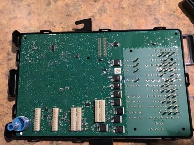

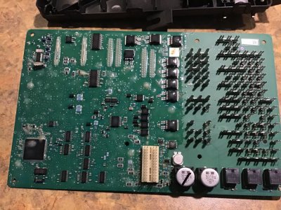

There is a small amount of corrosion on a couple pins, but no visible damage on the board
All fuses were verified as good, but no power to anything. We are checking every pin on the connectors to verify if power is making it from the battery to the SJB.

Check fuse F67 in the fuse box under the hood. It supplies power to the SJB.
