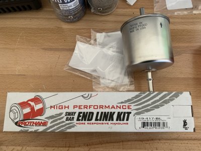

Got a few things in the mail this week. Got the plastic clips for the fuel filter and some sway bar end links (I've had some noises at low speed/tight turns).

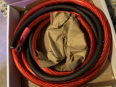

Last night I replaced the old battery cables, which were in even worse condition than I thought, with the PA Performance kit. I couldn't figure out the alternator cable yet because I couldn't see where it was routed exactly...but I will try to get that installed sometime in the next few days.
Old:
New:
