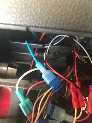

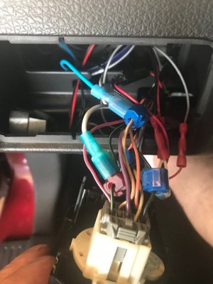

Bambam 06,
Here a couple of pics of how I tapped into the parking light. It's the tan wire/white strip with the tap to the blue wire. That provides 12v to dim the gauge lights when the parking lights are turned on.
As I said earlier your gauge lights should come on as soon as the key is turned on. If they are not then the gauge is likely not powered. If your gauges work differently scan/send us the schematic and we'll be able to tell you how to connect them to make them work. IMG_1470.jpg IMG_1469.jpg
