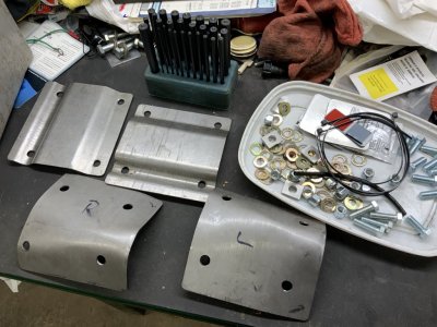

Hello race fans. If you have come to the realization that you need a roll bar to be NHRA legal as I have follow along and I’ll cover the high points and any problems of installing a Maximum Motorsports Drag Race Roll Bar. This model is bolted into the chassis, has a welded in cross bar and back brace bars that will be welded after fitting. The door bars are removable by removing two bolts each.
After unpacking and checking for a complete parts list, this is basically what I received.

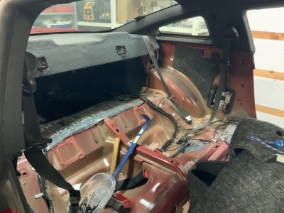

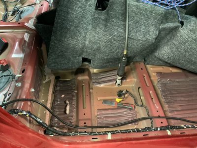

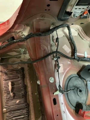

With the car up on stands and the rear wheels removed for access to the wells start by removing the front and rear seats. Next remove the sill plates, kick panels and the rear quarter panel trim. Unhooking the carpet clips under the sill plates and pulling a couple push fasteners will allow the carpet to fold to the canter console. I tied it with small rope to hold it out of the way.

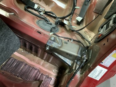

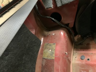

The B pillar has bolt in corner gussets. Go figure! Remove a little seam sealer around the bolts and edges of the gusset and then remove the bolts. Now pry the gusset from the chassis and scrape away any old sealer that would interfere with seating the new MM gusset. Use the original bolts to install the new gussets. Extra washers are provided for shims if needed for a good fit. I did not use any.

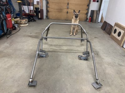

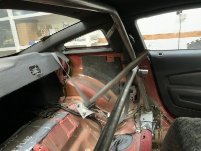

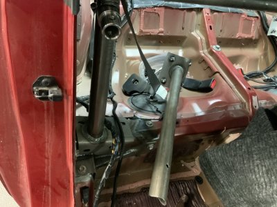

I managed to get the main hoop in the car without gouging or scraping anything but really at this point a second set of hands is needed. I will fit the back bars tomorrow.

Good info and thanks for sharing. I like your dog!

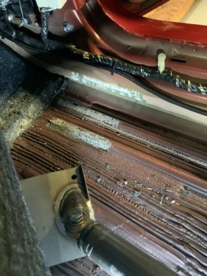

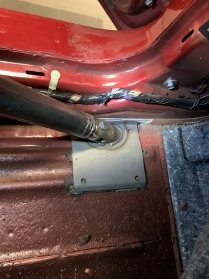

Moving on with the install. The instructions stress that the door bar mounting plates must set on the floor, snug against the sill. Seem sealer and sound deadening must be removed for a good fit. The asphalt sheet on the drivers floorboard is some hard stuff.

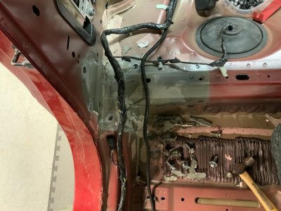

Drilled 16 mounting holes in the floor pan and rear wells. I was surprised how thin the steel is. A 1/4” pilot drill blows through and the 7/16” final drill doesn’t have to work hard either. The instructions stress to be careful drilling the holes in the drivers side floorboard. There are fuel and break lines under two of the holes. This is real! Do not drill through the break line. I slid a steel plate between the bundle of tubing and the floorboard.

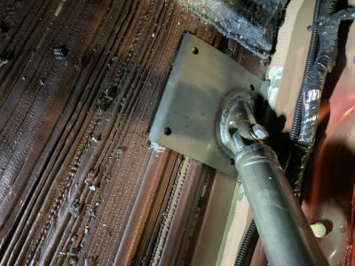

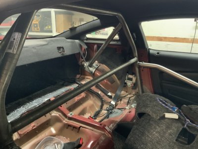

After the holes are drilled in the rear wheel wells you can fit the rear backup plates. I held the plates in position in the wheel well while my helper marked them for drilling from inside the vehicle. The front backup plates are predrilled.
