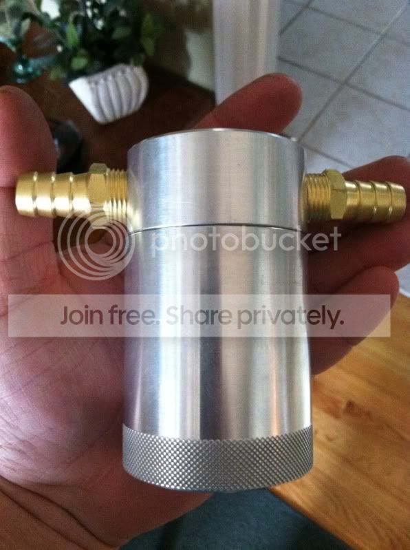

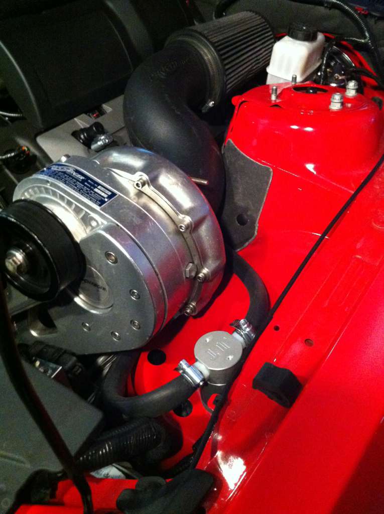

Here's what I use. Bought it off Amazon for $75. It has a drain in the bottom and works great. I have been using it since going with the Vortech last Dec.

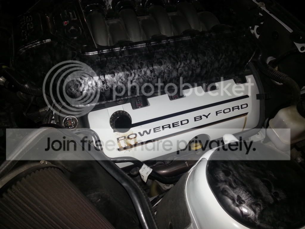

So this is how mines set up. From the passenger side I have running to the drivers, then it's teed to the can. The other end of the can if going to the air tube. My car is a daily driver and I only drag race 1-2 times a month if that getting 6-7 runs. Am I doing it right?

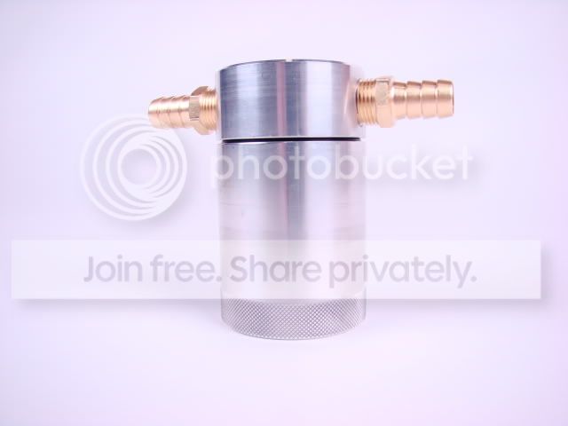

I have the moroso unit, can someone please explain the correct way to hook up both valve covers to it? Please. I had switched from the moroso unit to breathers but after 500 or so miles i ended up with oil coming out of the drivers side breather. I reinstalled the moroso unit today back on the passenger side, id like to be able to use it for both sides instead of spending more money for a drivers side unit.

I have the moroso unit, can someone please explain the correct way to hook up both valve covers to it? ]
You should not hook the Moroso catch can up to both sides. The driver's side allows for air to go into the crank case and the passenger's side allows oil and gasses to escape. To use the Moroso can set the driver's side back to factory and hook the passenger side up with the tube going from the crank case to the can and then from the can to the intake.
If you want to set both sides up to a breather search for a Peterson breather
Here I did it for you:
