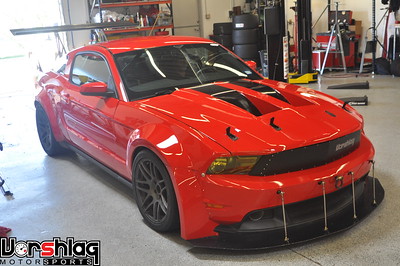

Project Update for July 1st, 2015: This is the last time I will have pictures of modifications to our red 2011 Mustang in this thread - because we no longer own it. Read below on what we did to sell it, plus a hint at what we're building next. We will continue to update this thread with work and parts we're making for other S197 Mustangs, of course.
Deconstruction of a Masterpiece?
Well maybe "masterpiece" is a bit pretentious, but I felt like we had an amazing package we had put together and was really bummed that we might have to tear it apart to sell the car. At the eleventh hour we got a "stay of deconstruction" from a potential buyer, so we ended up NOT having to remove the go-fast bits from this car after all. This makes me happier than selling the car and parts for more money.
Jason here at Vorshlag summed up our time with this chassis well:
Sold the S197 Mustang we used as a Vorshlag development car. I've worked on a lot of competition cars, but this one was the most rewarding. We continually developed the chassis, leaving the drivetrain stock, and ended up with an easy to drive and fantastically competitive car while retaining many of the street car amenities. This car set track records for it's class at every track we competed at. And then we set higher records every time we would revisit the track.
The new owner is a track day enthusiast in Michigan. Look for it at tracks up there.
Adios Big Red. Next up - The War Hammer!

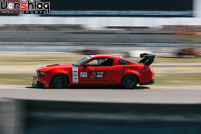

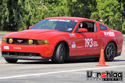

Spot on. We DID have a really good run in this car, setting 16 track records and winning dozens of events. We never had to use the "big horsepower" card to do it, either, which was strangely fulfilling. Suspension, tires, brakes and aero were our focus and these improvements went a long way. Keeping the engine bone stock made the package more reliable and was lower stress for me at every outing.
Brief Overview of Classes This Car Raced In

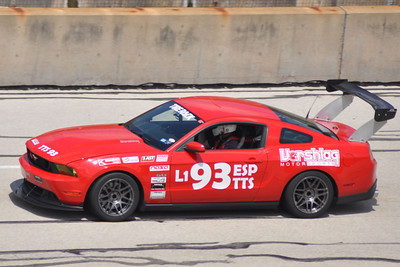

We custom ordered this car in the summer of 2010 and started working with shocks, wheels and tires in SCCA's "STX" class for autocrossing. At the same time we ran it in NASA's "TTB" class for NASA Time Trials. This was a somewhat frustrating period of racing for us, as the STX class limits (265mm street compound tires on a max 9" wide wheel) were just not suited to a big heavy car with V8 power, either on track or in autocross format.
We spent a lot of time slipping and sliding around on these skinny tires in STX, and I regretted going this route almost immediately. Strangely enough but had markedly better results in our brief stint of running in STU class in late 2011, which is the same basic rules but higher tire and wheel width limits (285mm and unlimited wheel widths allowed). Just a +10mm bump in tires and a 1" wider wheel made a remarkable improvement (275/35/18 Bridgestone RE-11 tire on 18x10 D-Force wheel was used).
We jumped back and forth from STU to STX in early 2012, but spent the majority of that year dabbling in two new classes on much wider and stickier R-compound tires: ESP (SCCA Autox) and TTS (NASA TT). We took the car to SCCA Nationals and grabbed a trophy in open and a win in ESP-L. The wider tires suited this car much better and that - coupled with changes in the suspension and aero packages - made for big improvements at the end of the year, where we edged our way up to some near wins in TTS.
2013 was a break out year for development on this chassis, and we started winning and setting track records in the newly named TT3 class immediately. We dominated TT3 in the Texas region that year but took home a disappointing 3rd at NASA Nationals, with big untested aero changes right before that event. 2014-15 were spent with this car still dominating in TT3 class, not losing a single NASA event during that time. We kept refining the package and scored a big win in Optima in 2014 and the car was faster than ever at autocross events on the NASA TT3 set-up. The car won its last two competition events with us, a Time Trial at TWS and an autocross at TMS, by huge margins.

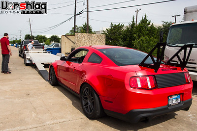

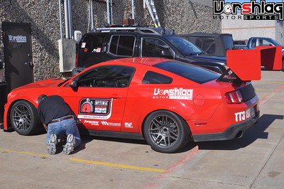

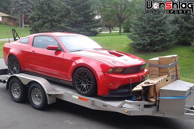

After reading my last post here where I had given up on selling it as a complete package, the new buyer decided to make a call and stop us from taking the car apart. I'm glad he did, because I really didn't want to do that.
Other than removing most of the decals, we left the car alone and just got everything cleaned up to perfection. Our shop manager Brad spent some time cleaning, detailing, waxing and getting this car ready for Eric to stop by our shop for a look. He had followed the build for years, but liked it even better in person.

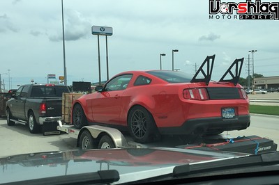

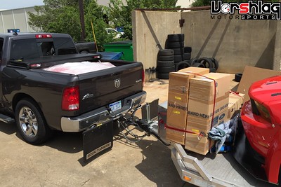

On Sunday Eric test drove the car and decided on all of the spares and OEM bits and pieces he wanted to purchase in addition to the car. Then Monday it was hotter than nine Hells when we loaded up the car and parts. After that we went to the bank to finalize the sale.

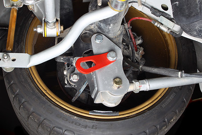

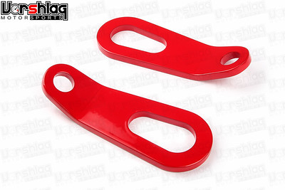

He appreciated the rear S197 Tow Loops we had installed on the rear axle, as looping an axle strap over the sold axle tubes can be a bit of a chore, especially when you have an aftermarket/rerouted swaybar or Watts Link in the way. We have towed many times with these tie-down loops and have installed about a dozen sets on customer cars. After this testing we have finally released this as a production product, about two weeks ago. You can order just the loops or add the optional longer rear LCA bolts as well.
I got a text Tuesday morning from the new buyer saying he made it home and everything was A-OK. Look for this car at track events at Gingerman, Mid-Ohio and other tracks near his Michigan location.

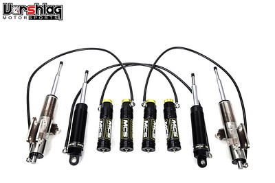

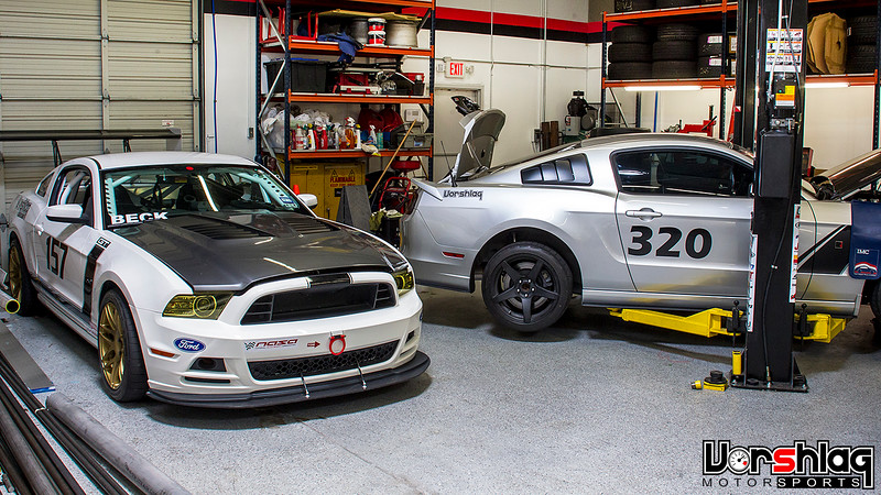

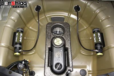

Both of these S197s above are getting a laundry list of work in our shop today, as I write this. The white 2013 GT is Jamie Beck's and we've featured it in this build thread before. The Silver Roush Stage 3 is owned by James Meeker, and has also been shown here before. The list of work we're doing to the white car on this round of mods is extensive and includes removing the AST 4150 coilovers and replacing them with MCS RR2 remote reservoir doubles.
The ASTs are fine. He just wants double adjustables and he went with the best option available from MCS, the RR2s. They worked so well on our TT3 Mustang that he went with what was proven to work. Jamie has also been waiting for more test time before jumping into Hoosiers, but with the complete drought of 295/35/18 BFG Rivals, he's running out of options. So that may happen sooner rather than later, as well as a laundry list of other mods we're tackling in the next 2 weeks.

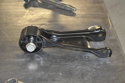

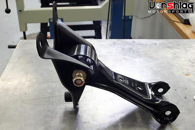

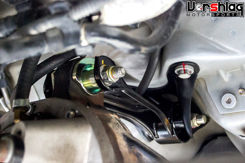

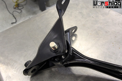

The various UCA designs on the S197 Mustang are a sticky subject. The OEM piece (below left) has a big rubber bushing at the axle and as well as the upper mount for the UCA itself. These are pretty soft bushings because they need to PIVOT quite a bit on the sold rear axle suspension, so they have a lot of bushing slop that can cause axle tramp, change of pinion angle, and slow down the rear suspension reactions to torque changes. If you have read this build thread for a few years you know we tested a variety of aftermarket designs and settled on the spherical UCA design from Multimatic.
This was a $700 arm + mount when new, which is pretty crazy, considering the Whiteline UCA + mount (above right) is only $242. But.... the current UCA design from Whiteline isn't my favorite solution for this arm. The "elastomer" they use is very firm (like polyurethane) and doesn't allow the arm to pivot, which could lead to premature wear on the axle side OEM rubber bushing (which has to do almost all of the pivoting). We've been hounding WL to release a new design with their Max-C bushing (which I showed from my SEMA 2014 coverage in this thread). Most of the other brands also use a poly bushing upper mount, or a spherical mount, but most of those are even less desirable than the WL unit, due to a number of factors (poor adjustment style, low end materials, and most of all - NOISE). Virtually all of the spherical bearing units we've installed made heinous amounts of noise.

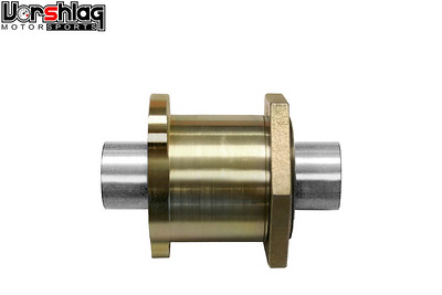

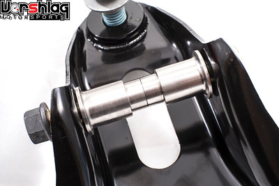

The Multimatic UCA design was elegant and simple. It uses modified, stamped steel OEM arm and upper mount, with a big spherical bushing added inside the end that is made to PIVOT SMOOTHLY, has no rubber to compress or deform, and has worked flawlessly for years in our car. The chassis mount is made to capture the bolt and machined bushings that fit snugly inside the spherical. Sure, it makes a little bit of noise due to it being all metal, but it works without any bind or slop. But you cannot buy them...

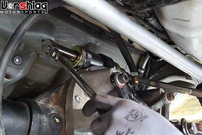

Since Jamie only found half the Multimatic solution, Olof took an OEM 2011-14 GT upper chassis mount and modified it to fit the Multimatic bolt, bushings and arm. This meant cleaning off the powder coating, making a reinforced washer to fit the included (non-OEM sized) bolt, TIG welding them on through the factory holes, and painting it all up.

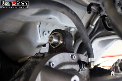

At the other end of the UCA is a rubber bushing in the axle housing, which was cracked and failing. This was pressed out (not fun) and the Steeda housing and spherical bushing were pressed in place (also not fun). Luckily we have a lot of specialty tools for pressing in and out bushings. And it still was a bear to reach everything, with the axle still attached to the chassis. All of this is easier with the axle on a bench, but then you have to disconnect a LOT more stuff + rebleed the rear brakes.
All said and done the install of the Multimatic arm, upper mount, and doing the Steeda busing install was 2.24 hours. On a lift, with all of the right tools, so if you are doing this at home on jack stands, expect it to take 3-4 times as long. Much of that was the R&R of the chassis side bushing, which was a $89 part from Steeda. Its worth it for the UCA, because this has to pivot considerably during axle movement and body roll. Now the upper control arm is spherical at both ends, and should pivot freely with no bind.

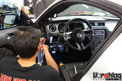

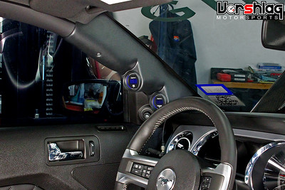

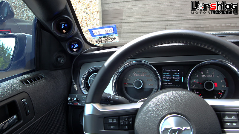

We have been watching the oil and coolant temps on Meeker's Mustang, which makes 633 whp with a supercharged Aluminator 5.0L Coyote based motor. But it has OEM analog gauges, which are barely adequate for a stock 5.0L that is only street driven.
During road course use it is VERY difficult to keep the fluids inside a supercharged engine cool, and we need better data to base the effectiveness of the cooling mods on. To see that data, a pair of aftermarket digital gauges were added for oil and coolant temps, at the hottest points in their systems.
Normally I'm not a fan of digital gauges (hello, 1984 Corvette!) but in this case we wanted to know the numbers with more resolution than an analog gauge, and we've had good results with this brand and style before. Since there wasn't a great place to mount the gauges without hacking up the dash, we picked up a two pod A-pillar mount for 2-1/16" gauges, shown above. We then sourced Autometer Cobalt Series 2-1/16" digital gauges with included electric senders for both the oil and water (Auto Meter 6937 and 6948). These gauges have temperature probes that were somewhat long-ish probes, and just jamming these into the oil or coolant streams would be difficult or cause other issues, so we made the installs a bit custom.

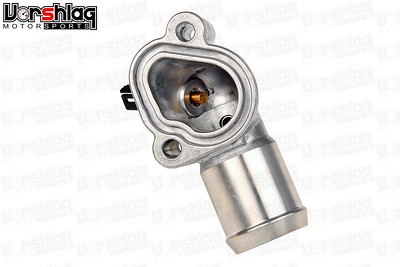

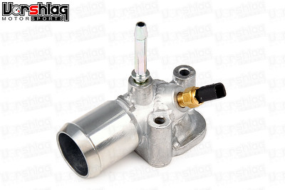

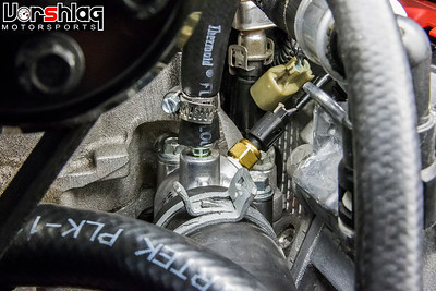

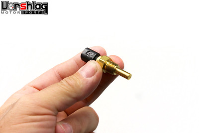

There isn't a great place on the head or block to add an aftermarket coolant gauge sender, so we looked at the cooling system layout and found the "hot side" of the coolant flow coming out of the block, but inside the thermostat (not on the "cool" side of the radiator). We purchased another OEM "Water Outlet Assembly" for a 5.0L motor, as shown above (so it would be perfectly clean and coolant/oil free, unlike the contamination we'd see on the used OEM unit). We also picked up aluminum weld-on bung from Fragola for the 1/8" NPT sensor.

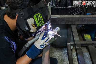

Olof then cleaned, drilled, and TIG welded the bung to this coolant elbow on the motor side of the system, then threaded in the sensor (with Teflon tape) and wired it to the gauge per the instructions. Since this is beyond most folks capabilities, we might offer some more of these "Water Outlet assemblies" pre-made with the weld-bung added for 1/8" NPT coolant gauge senders.

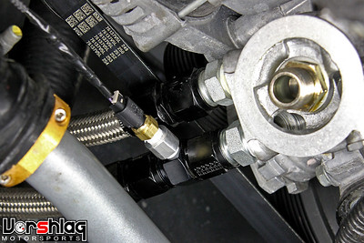

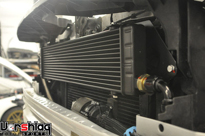

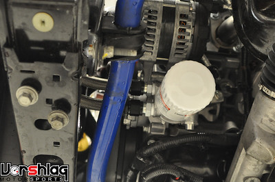

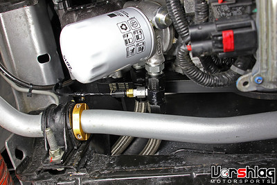

The oil temp system was a bit trickier. We already had a giant Setrab oil cooler on this car, with a thermostatic bypass plate at the oil filter (see both above) for the big -10 AN feed and return lines to the heat exchanger.

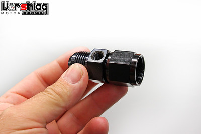

We used another Fragola part to replace the fitting that went into the sandwich plate oil adapter, on the hot side. This -10 AN fitting has an 1/8" NPT threaded hole in the side for a small oil feed line or for temp probe, like we needed. Normally you could just screw that sensor in here, but it could have bottomed out inside the new fitting. Even if it did fit, the probe itself would be stuck right in the middle of the fluid stream and could restrict oil flow.

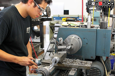

So a thick walled piece of aluminum tube was purchased. Olof chucked this up in the lathe and made a spacer, that was threaded on both ends (1/8" Male NPT into the fitting and 1/8" Female NPT for the sender side) then had two flats machined on it for installation with a wrench. Thank goodness for fabricators and good tools. The sender went into this "stand-off" and the tip of the sensor was right in contact with the oil stream.
Visibility for the new digital gauges was great, daytime or night. And since the OEM analog temp readouts were just "green/orange/red", after his next track day we will finally have some reliable numbers to critique for coolant and oil temps.

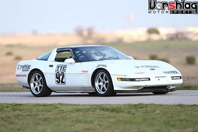

We are still waiting on the rebuilt motor for my TTC 1992 Corvette to return from the engine builder, and time is ticking away. The goal is to have a couple of track events in the car to finish tuning the ride heights and to get some seat time before NASA Nationals East at VIR in September.
But that car has maybe the rest of this season before its kicked out of TTC class, which we kind of knew going in when we built it in January. It will likely be sold at the end of this season, as it was more of a "fill the gap" car between the red Mustang and our next "halo car" for the shop...

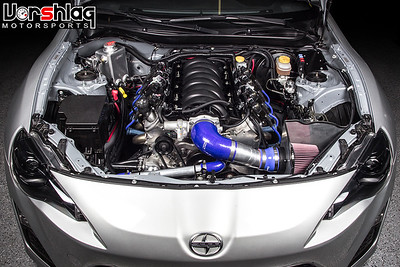

This FR-S LS1 is an "Alpha" build we have been working on for about a year that is nearing completion, and already driveable. The swap kit production will start shortly after the final test drives. If you are in the DFW area this Saturday, come to the show and take a look at what we have on display. We will be parked near the SCCA crowd at the back corner of the giant lot there at Classic BMW in Plano, Texas from 6:30 am until around 11 am.
