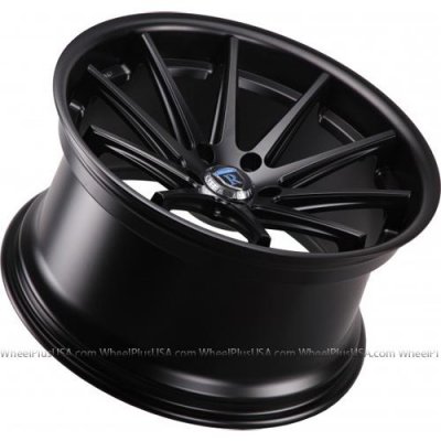

I just ordered and should be receiving Rohana RC10's, what does everyone think?

I think you need to ask a more specific question in a thread other than this one.
Yes you are right I should have been more specific, I apologize. I am simply curious as to if anyone has an opinion of Rohana as a brand, I was unable to find out much about the company and "took a chance" on ordering the wheels. They will be 20x9 +25 and 20x10 +40.
