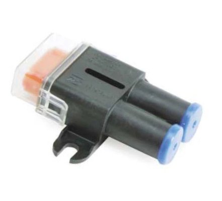

And the opposite end WPT-916
rocknrod
Feb 23, 2024
245
124
China Spring, TX
So having said all that with shipping tax and such it's probably well over $120 just for the parts. So is it worth it?
Plus you have to "hope" when you put it together it works ... Or buy it from him for $180.
Might have to buy it. :)
It was fun exercise for me.
