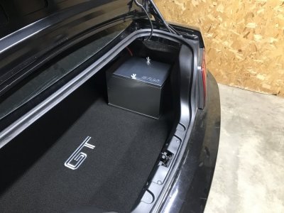

Ground is in the trunk. Seen differing opinions about grounding at the trunk or running a cable to the front. Both seem to be fine and haven't seen any reason why one is better than the other. Cable is 1/0, typo on my part which is fixed now.
I just went through this a few months ago, and it wasn't too bad of job. You look to be on the right track. The hardest part for me was figuring out which junction block to run and where to mount it. I went with this: https://www.amazon.com/Fastronix-Power-Distribution-Block-Cover/dp/B078VGKC8T/ref=sr_1_2_sspa?crid=34FWEQ6NTBGNQ&keywords=junction+block&qid=1643749300&sprefix=junction+block,aps,134&sr=8-2-spons&psc=1&spLa=ZW5jcnlwdGVkUXVhbGlmaWVyPUEzOEVZUldDNFVVVFVKJmVuY3J5cHRlZElkPUEwOTcwNDAzOEs2MEU4QjlOSzBKJmVuY3J5cHRlZEFkSWQ9QTA1NjEwMzcxRjFRQkRCUEhRMlkwJndpZGdldE5hbWU9c3BfYXRmJmFjdGlvbj1jbGlja1JlZGlyZWN0JmRvTm90TG9nQ2xpY2s9dHJ1ZQ==
And ran it right into the firewall where the battery used to sit using some self tappers
