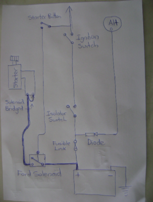

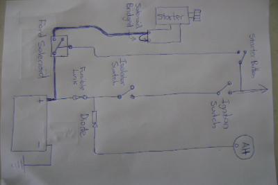

On my last race car [an Aussie Falcon Touring Car] we used a Ford Starter Solenoid mounted on the battery box as an Automatic Isolator for the H/D cable to the starter motor.
This main cable was dead as a Dodo except when cranking so no fuse was needed [the solenoid at the starter motor was bridged]
The main feed and charge wire were of a lighter gauge and easily fused.
All we needed was an extended wire from the ignition switch to the starter solenoid.
Here is a simple Schematic [I hope it's readable]

You leave the charge wire on the Battery side of the Isolator Switch! This prevents the Alt charge backfeeding to the ignition and keeping the Engine running.
But as you observed it remains hot all the time!
The simplest remedy is to add a H/D diode in this wire [close to the battery as possible]
This makes the wire dead as a dodo when trying to discharge the battery, and hot when the Alt is charging the battery.

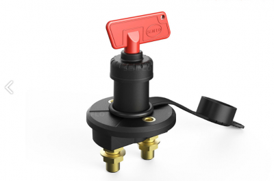

If you use the marine style battery isolator switch on the fender /base of the windshield [below]
Clock/Rotate the switch in a position so the Flag/Key is Trailing in the on position and East/West in the off position.

I use the very same Battery Isolator switch [above] on my Trailers and all my race cars.[they are waterproof]
My present race car is a factory FR500C and Multimatic installed the very same switch [on the roll-cage "A" pillar]

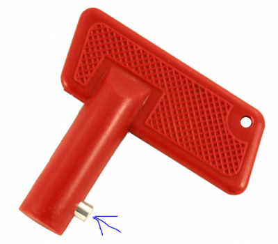

Underneath the Rubber "hat" on the switch it looks like this [below]
There is a groove where the key drops in.
I drilled a tiny hole where I marked the arrow [then installed a self tapping screw], I then carefully shortened the screw with a file so it would NOT touch the shaft of the key.
This screw goes above the little dowel in the master key [in the groove] and prevents the key from being lost or coming out
Re-assemble with some electrical grease and slip the "hat" over the screw/ outer body.
In 40+ years involved in racing I have never lost or misplaced a master key [even when towing to the track]
I even retro' fitted this on my FR500C

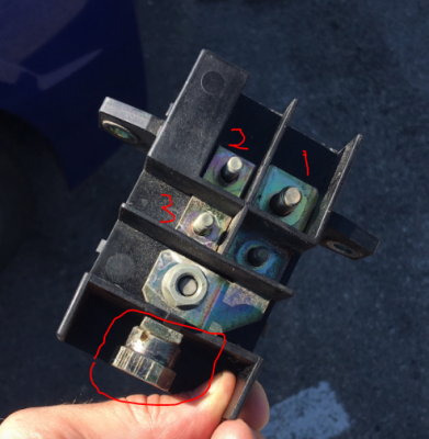

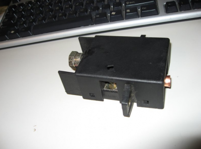

Another Cheat method is to use a "battery distribution block" [jump start block] from a BMW E36 ['90-'00 3 series] as a cable Joiner
These are on the Right Front inner fender.
BMW use these to take a power Feed from the trunk mounted battery.
Then distribute to the starter motor ,and the main harness.
You will have a ton of room with your battery box removed [and these look really neat and professional]
Here is what it looks like with the side cover removed [1: is Battery , 2: Starter, 3: Harness Feed, and circled is to Jump start under the plastic cover]
Last time I got one I paid $20 including all the wiring H/D cable back to the battery.
Also use star washers under all your ground straps

O.K., starting this project. Figured out it's simple to upgrade the starter/BEC cables, so those are going to 1/0.
Clarification on the two grounds that came from the battery to the chassis and the engine block. Now the battery will be grounded to the chassis in the trunk. Will running a ground from the block to the chassis be sufficient? Do I need to add another ground in the bay? Thx...

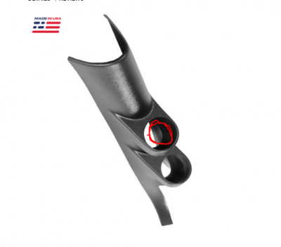

Just working out where to mount it or more so, what I need to drill a hole through.
A trunk mounted battery is on my to do list but I really don't want a switch or pull rod visible on the back of the car since it's 99% street driven. I figure I'll do this either by mounting the switch directly to the bumper cover behind the licence plate and building a raised plate bracket to clear it or mounting a push / pull switch in the spare tire well and making a detachable pull rod that comes out through a hole behind the plate.

I just bought a new one on Ebay, i am planning on only using #1, Batt and#2/#3 for harness. Do i seal the rest, as i will not use them.
Are you referring to the BMW battery distribution block, And a trunk mounted battery?
Are you going to use a Battery isolator cut off switch? or not?
If you look at the BMW battery distribution block , diagonally opposite #2 is a 4th post.[below]
This is where BMW hook up the Charge Wire from the Alternator [so they only need one cable back to the battery]
If you're using a battery cut-off/isolator switch [for motorsport], do not connect the charge wire there.
You must run a separate charge wire back to the battery + [or the battery side of the cut-off/isolator switch.
This way the Alt charge only feeds to the battery and cannot feedback and keep the engine running when the battery cut-off/isolator is switched off [when the engine is running]
If you're not doing motorsport , you could hook up the Alt charge wire to post #4 and just use a battery cut-off/isolator switch anywhere in the main battery cable [or ground cable]
This is only make the whole electrical system dead for storage or working on a vehicle..... It will not kill a running engine [a motorsport requirement]

To anybody with the Battery Cut-Off/Isolator switch mounting dilemma.[especially with motorsports in a street car]
Here is where the factory mounted the Battery Cut-Off/Isolator switch on the FR500C.
[on the A-Pillar of the roll cage] so it can be reached by both the driver or the safety crew outside [there is the decal on the outside]
On a nice street car you could get more creative without a roll cage and use an A-Pillar gauge pod and mount the Battery Cut-Off/Isolator switch there.
And race with the side windows down.
You can buy universal single pods, but with the dual pod you could mount a decent warning light or shift light in the lower pod. [or a starter button]
